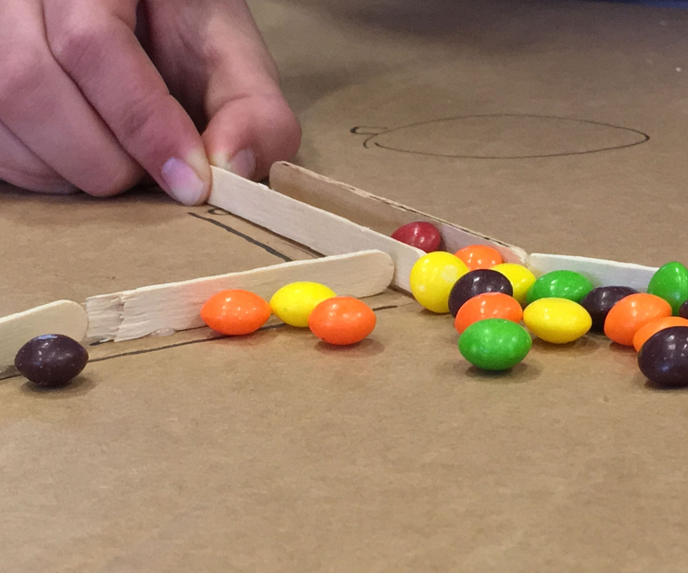

Discouraged, I tell a student the challenge and he suggests making a bearing. Pool balls are there and the idea develops to use pool balls as ball-bearings. Slingshot ammo is one sixth the size of a pool ball.

The motion platform feels like a blank canvas for design ideas to access and shoot the balls. I do a lot more sketching and then it pours rain outside for a few days straight. Work gets canceled. I stay home and build a prototype.
Step 5: Test the Geometry
I talk with a science teacher using stop motion video to have students learn about proteins. I am inspired to test the geometry of the Judith prototype using stop motion. The geometry seems to work for straight forward shots.
It feels like time to start adding programmable motion control to the system.
