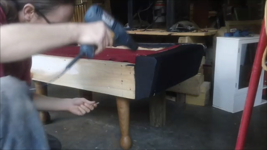

I took one of the three parts to use as my bench. I cut a piece of pallet wood to the size of the front and used nails, screws and wood glue to attach it. Then I traced out the shapes that were on each side and used a jig saw to cut out these pieces, keeping the natural shape of a pool table.

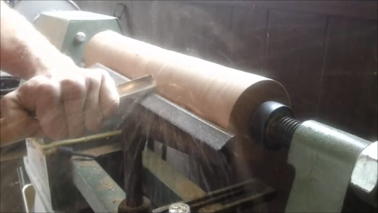

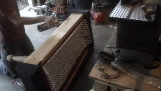

I used a fence post that we already had out in the backyard to cut four legs to keep it off the ground while I worked on it. I liked the way they looked, so I decided to keep those legs on the back, and turn two front legs on the lathe. I used a big beam from a pallet to turn the legs. They were all attached simply by putting a long screw straight down from the top, then adding a couple of screws from the front and the sides. This kept them very tightly secured.

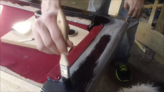

After a bit of trial and error, I decided to go with a flat black paint. It looked clean and did a great job of masking some of the dings and whatnot that existed in this old pool table. I put on two coats, and this thing was finally starting to come together.

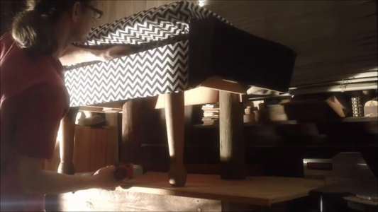

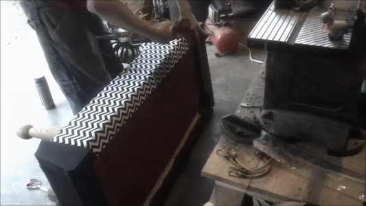

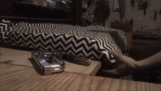

On the front piece, I cut out a piece big enough to have a bit of overhang at the top and bottom. I stapled the top in place, then flipped it over. I added spray adhesive to the fabric and the wood, then pressed it down nice and smooth to make sure there were no wrinkles. I added some staples to the bottom just to make sure it held tight while the adhesive set.

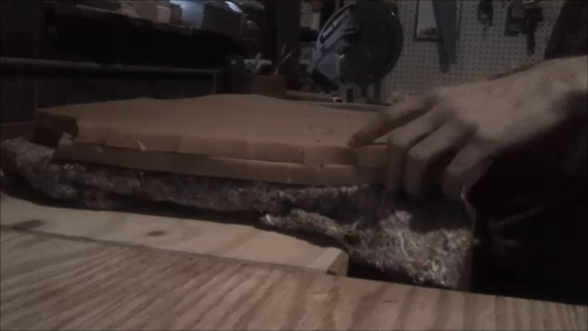

For the seat, I cut a piece of plywood slightly bigger than the top, so there would be a bit of an overhang at the front. Then I cut up some old bedding to the size of my plywood. The bedding went through a couple of cycles in the washing machine and came out really clean and fresh smelling. I simply stapled the fabric down on one end, then worked my way around the seat, making sure to pull it as tight as possible as I went.
To attach the seat to the bench, I needed someone to sit on it to keep it down some I could add some screws from the bottom. Obviously, make sure and use the right size screws so they won't poke through the wood into the seat.
