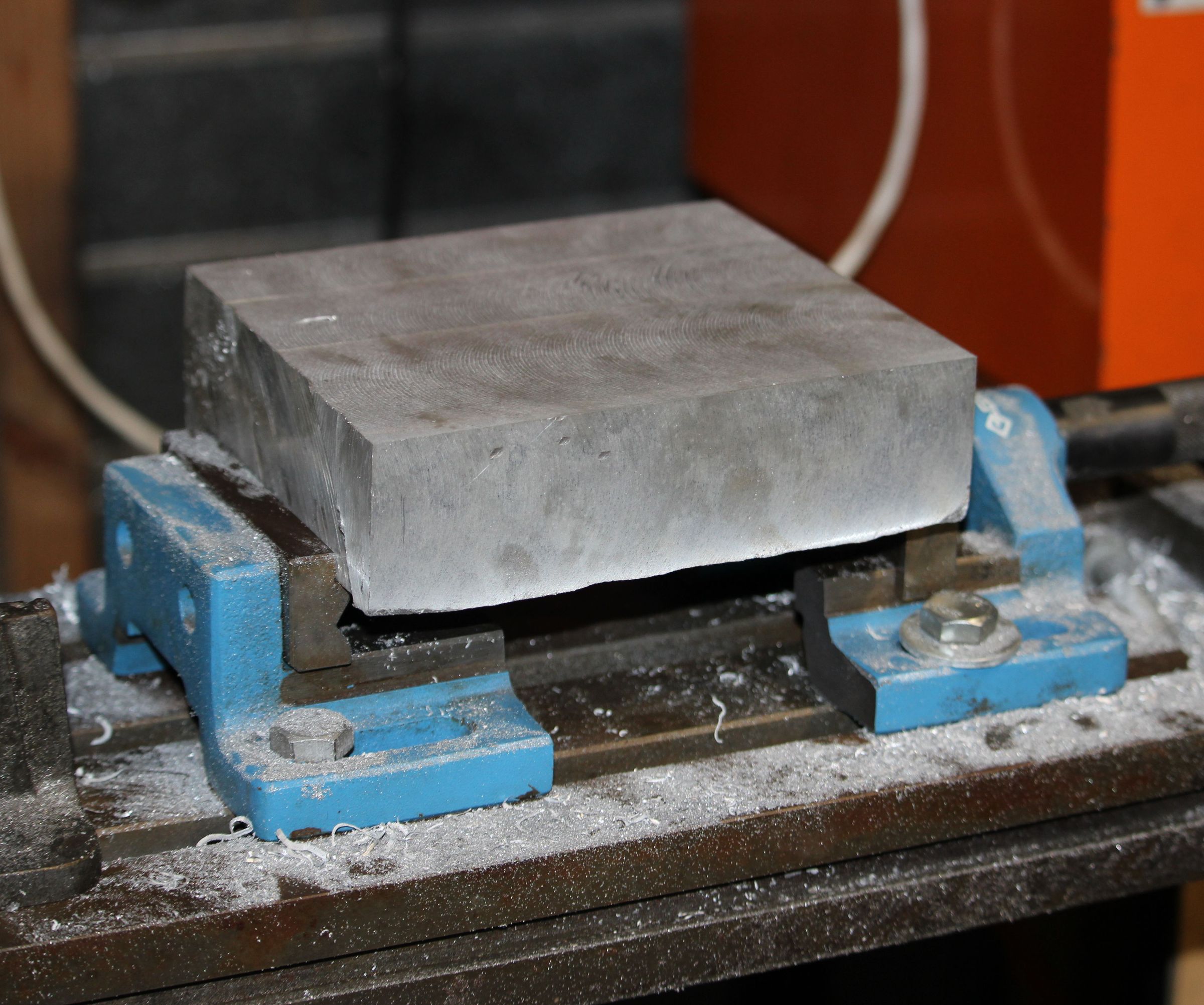

With a milling machine, so often the finish on the part is dependant upon the ability of the operator to feed smoothly. Early on when I bought my milling machine (used) I came up with this simple 'adapter' which allows me to use a battery drill as a power feed.
The adapter has had hours of use and was super simple and cheap to build.
The photos are all staged and the embedded YouTube clip probably gives the best description and demonstration of it.
