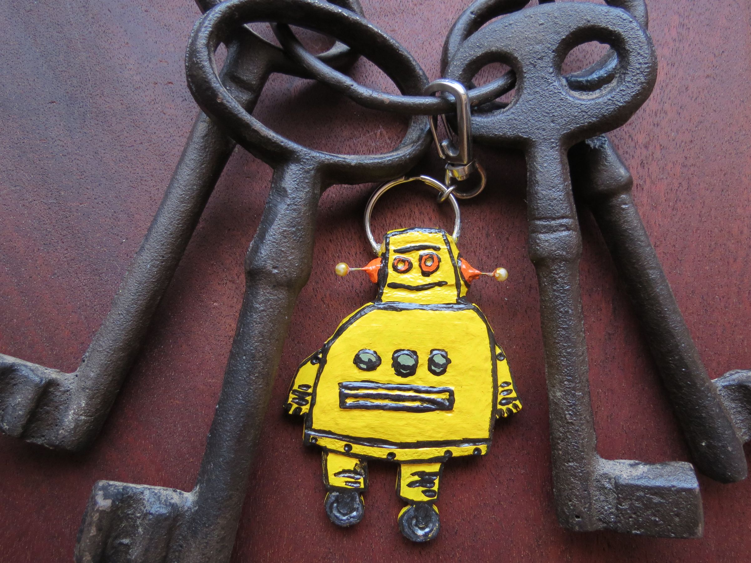

Step 4: First Layer
Add a nice thin layer Bicarbonate of soda. (henceforth to be referred to as powder.)
Flatten it with the credit card.
Step 5: Glue It
From one side add drops of glue, saturating the powder.
Step 6: Second Layer
Start adding next layer asap.
The idea is to sprinkle powder over the still slightly wet glue. It will absorb the rest of the glue and continue to build up.
Keep sprinkling until it looks dry, Take care not to heap it up to thick.
This is also the start of the next layer.
Step 7: Continue Buildup Until Nice and Thick
Continue building it up for thickness and integrity.
Step 8: Cut It Out
File/grind whatever.
Make it smaller.
Make it smaller.
Step 9: Build Up Some More
Use paper pieces to build the sides up nicely.
Step 10: Make It Flat
Start grinding or sanding it flat to show imperfections.
Build up the imperfections and flatten it again.
Step 11: Add the Key Ring
First, tape the ring with the plastic or masking tape. Its so to glue don't stick to the ring. It must be able to rotate to work nicely.
Step 12: Some Detailing
Add detailing where it must be built up some more.
Flatten back side with ring.
Step 13: Continue Builtup of Detailing
Add the antennae.
Step 14: Build Up; Build Up; Build Up.
Yip.
Build it up some more.
Step 15: Detailing and Refining
Add detailing, use a dremmel and start working out the detailing and finer points.
Step 16: Detailing; Detailing; Detailing
Put the rest of the details in, and cut it with dremmel.
Can use dremmel to carve out relief and add extra detail.
Step 17: Splash Some Paint on That Thingy
Paint it and your done!
One good quality, acrylic / heavy plastic feel-alike Key holder.
This stuff works wonders to fix things, fill holes and more.
Can be filed to high quality finish.
The thinner you build layers, the higher quality item you get.
Its stronger then you would think.
Enjoy.
