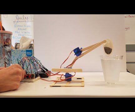

Introduction: Popsicle Stick Robotic Arm
Here's how to build a simple robotic arm with a gripper using popsicle sticks, an Arduino, and a few servos.
Feel free to use similar materials or whatever you already have. (e.g. cardboard instead of popsicle sticks)

Step 9: Build the Base for the Whole Robot!
Materials for This Step:
- 6 Popsicle Sticks
- Hot Glue Gun
Instructions:
Lay 3 popsicle sticks down in one direction. Then lay 3 popsicle sticks in the other perpendicular using hot glue to connect everything.
Step 10: Connect the First Servo
- The single servo with the middle of the popsicle stick glued onto the servo
- Hot Glue Gun
- The Base for The Whole Robot from the last step
Instructions:
Glue the bottom of the servo onto the base.
Step 11: Attach the Second Servo
- The servo with the stack of popsicle sticks attached to the base
- The structure from the last step
- Hot Glue Gun
Instructions:
Orient the servo sideways so that the popsicle stick can rotate upwards in the air.
Glue the bottom facing edge of the popsicle stick stack to the existing structure. (see picture)
Step 12: Attach the Third Servo
- The last servo with the double direction horn
- Hot Glue Gun
Instructions:
Glue the servo to the end of the existing structure's protruding popsicle stick so that the servo's popsicle stick rotates away from the center of the robot
Step 13: Attach the Last Servo! (Gripper)
- The last servo
- Hot Glue Gun
Instructions:
Glue the large flat side (as opposed to the bottom of the servo used in previous steps) to the close side of the last servo's popsicle stick so that this servo's popsicle stick rotates in the same area as the last servo's popsicle stick.
When gluing, make sure to angle the servo so that when the servo is rotated about halfway, the two popsicle sticks touch at the very tip.
Above is a picture of an open and closed gripper.

Step 16: We're Done!
Turn the potentiometers to control the robot!
