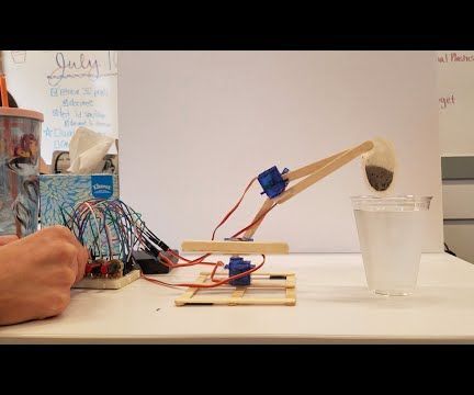

Step 1: Calibrate the Servos
Attach the horns (white wing attachments) to the servos by popping them on top of the servos. Three of the servos need the horn that extends in two directions while one servo will need the horn that extends in just one direction. Turn the horn counter-clockwise as far as it will go. Pop the horn off and then back on at the calibrated position. One of the servos with the two-direction horns needs to be calibrated parallel to the servo while the other three need to be perpendicular to the servos. Screw the horns in using a small screw and a screwdriver.
Step 2: Prepare the Servos
For the servo that was calibrated so the horn is parallel to the servo, hot glue one end of the popsicle stick to the flat side of the horn. For one of the two-direction horned servos that was calibrated so the horn is perpendicular to the servo, hot glue one end of the popsicle stick to the flat side of the horn. For the other two-direction horned servo that was calibrated so the horn is perpendicular to the servo, hot glue the middle of the popsicle stick to the flat side of the horn. This step is different, the popsicle stick it not on the flat side of the horn. For the servo with the one-direction horn, hot glue one end of the popsicle stick to the thin clockwise side of the horn.
Hot glue 4 popsicle sticks together so that they stack on top of one another. Glue the flat side of the stack to the bottom of the servo that was calibrated to be parallel to the servo. Tear off any excess glue around the edges so the stack can lay flat.
Step 3: Assemble the Structure
Lay 3 popsicle sticks down in one direction and 3 popsicle sticks perpendicular to the first 3 to create a grid. Hot glue all the pieces together. Glue the bottom of the servo that has the middle of the popsicle stick attached to the base you just created. Orient the servo with the stack of popsicle sticks attached so that the popsicle stick attached to the horn can rotate upwards into the air. Glue the side of the popsicle stick stack to the popsicle stick on the base servo. Glue the last servo with a two-direction horn to the popsicle stick on the previous servo so that the popsicle stick rotates away from the center of the robot. Glue the side of the last servo (as opposed to the bottom) to the popsicle stick on the previous servo so that when this servo rotates, the ends of the two popsicle sticks will close and act as a gripper.
Step 4: Wiring
Build the circuit shown. After programming the Arduino, this will allow you to control each of the servos with the corresponding potentiometer.

Step 6: Troubleshooting
Nothing is Moving: Make sure the battery pack is on and the Arduino is plugged in. Double check the circuit to make sure everything is connected correctly.
A Servo isn’t Working: Try pressing the reset button on the Arduino. Sometimes the servo stops working if its been pushed too far. The servo may be dead, try replacing the wires with the wires of a working servo to see if this servo is working.
A Servo is Jittery: The servo may be bearing too much weight. Try adding a capacitor to the wiring of the servo.
