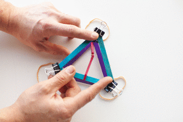

Step 6: Add Rubber Bands and Assemble!
Now, take the three #32 rubber bands and place one under each binder clip of one of the triangles as shown. This is the easiest way to do the tricky part of assembling this whole contraption. Take the smaller #8 rubber band and hang it in the notch of the clip on this same bottom piece.
Take your other triangle and clip the notch over the little rubber band in the center and push down a bit to stretch the rubber band. Then, carefully attach each of the three other rubber bands over the top of its corresponding binder clip on the top triangle piece. You need to hold on to the whole thing while assembling. Don't get frustrated if this part takes a few tries and minor explosions to get right! If you're having a hard time visualizing how this all goes together, see the photos above from lots of angles and think about how you might best orient things to get this all assembled correctly.
Once all rubber bands are hooked in place, your table will magically be floating in the air! You can make small adjustments to the table so that the top triangle sits directly over the bottom one. You might need to wiggle the 3D-printed clips around a bit so they meet exactly in the center, and ensure that the rubber bands are around the little silver wires of the binder clips and not the black body part.

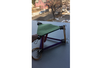

Step 7: Test Your Table's Strength
Now it's time to see what this thing can hold. Start with lighter items like LEGO mini-figurines or small toys, and work your way up to heavier items. If you have something a bit heavier and bigger - like our 3D printed model of the University of Montana's Main Hall, you'll need to get the center of gravity right over where the rubber band in the center is - if it's too far off to one side or the other, it pulls the whole thing too far to that side and the tension of the rubber bands becomes too far off balance, eliminating its integrity. We also have some small weight sets that we can add incremental 50g weights to (up to about a pound/500g) to test out the max capacity, which is a handy way to increase the load until it fails if you are looking to test that.
If you add too much weight or it's not balanced in the center of the table, it will fly apart - don't worry, though, it's very easy to put back together again and again!
