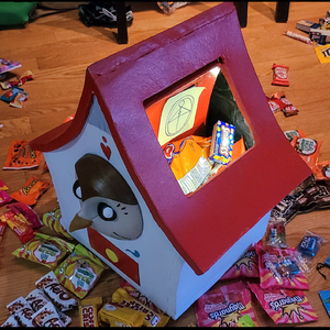

For our costume, Luz from The Owl House, we knew a plain candy bag just wouldn’t fly. So we set out to make Porta Hooty, the backpack that’s equal parts storage, sidekick, and unsolicited advice owl.
  1. Built from EVA foam for the house shape.
  2. Reinforced with a pressboard frame to handle Halloween candy weight.
  3. Featuring a working roof hatch with a fabric hinge and magnet latch.
  4. Glowing with LEDs behind a hand-drawn Light Glyph on a yellow Post-it note.
  5. Topped with a 3D printed Hooty face.
The final result glows, opens for candy, and stays wearable all night or all Con depending where you bring him.

Step 4: Roof Hatch and Candy Door
  1. Cut roof access door.
  2. Hinge with gaffer tape and superglue for extra hold.
  3. Secure an extra piece of tape (1cm by 2.5cm) at the oposite side of the hinge to act as a pull point.
  4. Add magnet latch (screw and inset magnet which we glued and covered with tape).
  5. Test opening and closing.

Step 8: Light Glyph / LEDs
  1. Draw Light Glyph on a yellow Post-it note.
  2. Place Dollar store fairy lights inside the house.
  3. When the candy door opens, the glow fills the interior storage area.
