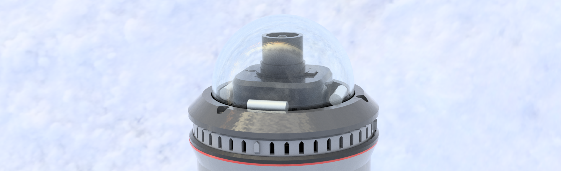

Inspired by the Thomas Jacquin Allsky concept, Allsky Go is the latest innovation in all-sky camera technology— engineered for seamless use both off-grid and at home. With smart features, sleek portability, and robust casing, this camera is built to capture the night sky wherever your curiosity takes you.
🌌 Allsky Go! - Pursuit of Dark Skies
Whether you are camping under remote starlit skies, exploring new destinations, or gazing from your own backyard, Allsky Go! is your cosmic companion—ready to reveal the magic of the night wherever you roam. Discover the stars like never before with a compact, smart, and rugged system built for travel and exploration.
