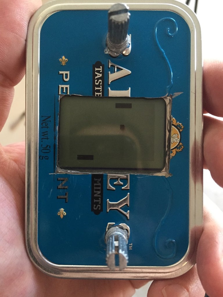

Step 2: The Case
The box I used for this project I got from a flashlight I bought, it is aluminum.
I marked the middel of the box andwhere the LCD is going to be. Make two holes for the potentiomiters and for the two switches.
I used a Dremel to make all the holes.

before you mount the game to the box its smart to test if everything is working as it is seposed to.
when you know where all of the wires is going to be than mark them with paper and tape like I did in the photo.
Step 8: Finishing
Mount the LCD, potentiometers and switches to your box, than connect all of the wires to the Arduino uno and connect the 9v battery.
Step 9: PLAY!
Now you got yourself a portable mini arcade machine that you can play with your friends or by yourself.
