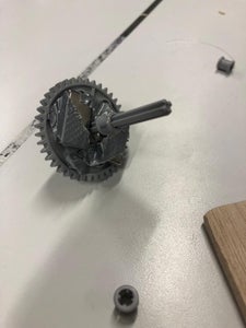

Step 1: Gear Setup
Take a medium length rod and slide a large and small sprocket onto it, do this 2 times. 1 should come slightly higher than the other, this can you determine by the spacers.
We are gonna call the right one the large gear setup and the left one the small gear setup.
Step 2: Magnets

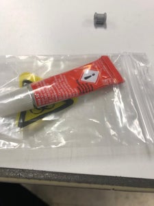

Using superglue(and tape as reinforcement) you are going to stick the 2 magnets to the small gear setup.

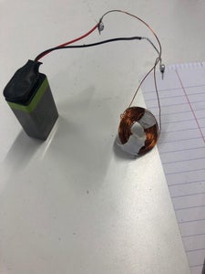

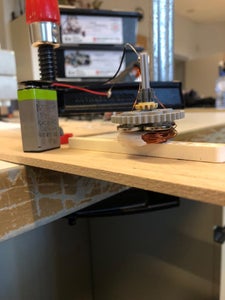

Step 3: Coil
Now make a round flat coil and attach the 2 ends to the plus and minus pole wires of the self-charging battery

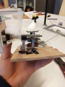

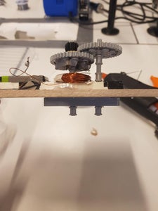

Step 6: Everything Together
Now you're going to put everything together.
You put the coil on the furthest hole and on that you put the smaller gear setup (the one with magnets), next to it you put the larger gear setup. Make sure that the big sprocket of the larger gear setup matches with the small sprocket of the small gear setup. You can use Duck tape of glue for firmness.

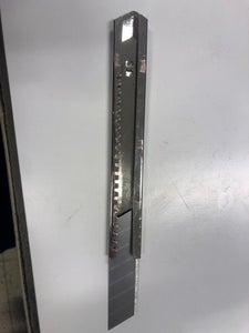

Step 7: Cutter Knife
You take the metal part of the cutter knife and replace the knife with a little piece of wood. Then you are going to make glue lines and stick them together and on the lego bar with ribs. Do this 2 times, 1 time on the bottom of the lego bar with ribs and 1 time on the side of the lego bar with ribs.

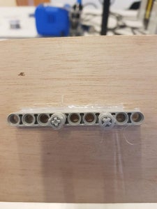

Step 8: Lego Bar With Ribs
Then take a nail and glue it to the piece of wood and stick it in the glue.
Step 9: Everything Together
Glue or tape the small cutter knife on the wooden board. You can change the position of the large gear setup so that the bar is connected with the gear.

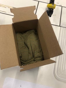

Step 10: Casing
Take your box and make a hole in it to allow the ribbed rod to pass through. You can soften the bottom with fabric, to give you construction some security, .

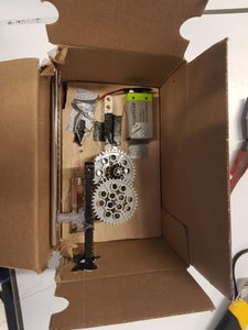

Step 11: The Box
Now put everything in the box, you are going to need to cut the box and tape it back together.
