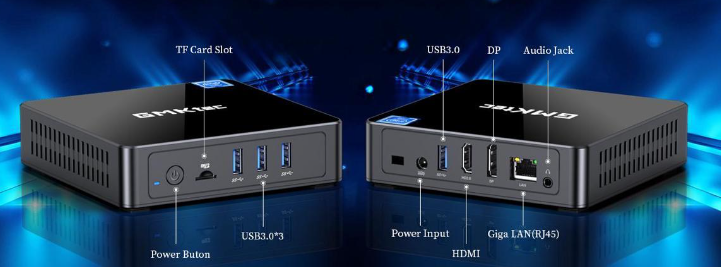

Step 1: Mini-PC
Pick a Mini-PC. Look for NUC boxes.
- Match with Power Bank power output (see Step 2)
- HDMI output - or Display, or USB video (see Step 3: Monitor)
- USB ports (3.1 or more)
- WiFi
- Headphone jack
- Bluetooth - nice, but not required
- Ethernet port (RJ45) - nice, but not required
- Fanless is recommended, but fast CPU PCs will need fans
- DC power input
- Note the power requirements. The specifications for the DC Voltage and Amps.
Example of what I picked:
- $189 URL: https://www.newegg.com/p/2SW-0032-00006

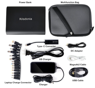

Step 2: Power Bank
Pick out a Power Bank that will match the Mini-PC power requirements.
- Ideally, the Power Bank will have a selectable DC output. One of the voltages will need to match the Mini-PC's requirement.
- There should be a USB-C port that can deliver 5V and/or 12V
- Also, consider the power requirements of the monitor and other peripherals you'll be adding. Add up all the watts needed. Get "Watts" by multiplying Amps times Volts (P=I*E, Watts=Amps*Volts)
- Alternate between Step 1 and Step 2 until you find a match.
- This is more than twice the capacity needed.
- $126 URL: https://www.amazon.com/dp/B074N1B15F/

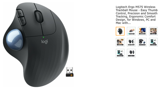

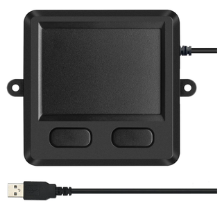

Step 5: Input Device
- Get one or more of: mouse, trackball, or touch-pad
- USB is preferred over wireless
- Bluetooth is OK, but batteries need replacement/charging
- If you go with a wireless device, be sure to have a wired mouse handy, so the device can be re-paired.
- I like trackballs, because no extra table space is needed, and for me, it is more precise than a touch-pad.
- $41 URL: https://www.amazon.com/dp/B08TLYK78K
- Touch-pad
- $29 URL: https://www.amazon.com/dp/B09X2MZL3C/

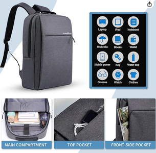

Step 6: Backpack
- Pick one with multiple compartments.
- One or two big ones for the monitor and keyboard.
- Smaller areas can used to hold the computer and Power Bank
- Backpacks for small computers are a good place to start looking.
- Some backpacks come with USB power ports.
- Plan how the cables will be routed.
- Holes will be cut between the compartments.

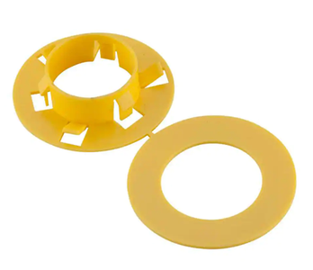

Step 7: Cable Bushing
- You will be cutting holes for cables between the different compartments in the backpack. These "bushings" will keep the material from fraying, and it will look better.
- Duct tape could be used. Or you could sew fabric around the hole edges.
- The images in Step 9 will show the holes and cables. The video in Step 10 will make this even more clear.
- $7 URL: http://tinyurl.com/mwbk4637
