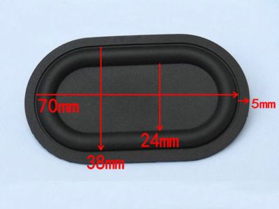

Speaker Driver Holes:
- 50mm diameter (2X)
- According to Rugged Passive Radiator (size mentioned in picture)

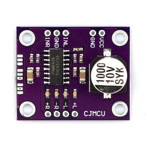

Amplifier:
PAM8406 class D audio amplifier.
- Features Dual channel stereo output 5w + 5w power.
- Works with 2.5V-5v power supply. High amplification efficiency 85%.
- can directly drive 4 Ω/8 Ω small speakers. Good sound quality & noise suppression Unique without LC filter class D digital power board.
- Can use computer USB power supply directly.

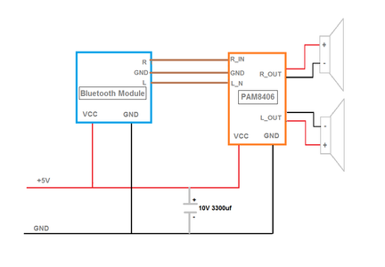

Connect the the +5v point of the amplifier to the output +5v of the charging circuit and Audio IN point to the audio output of the bluetooth module. Adding 3300uf 10v Capacitor in parallel with +5v and GND.
