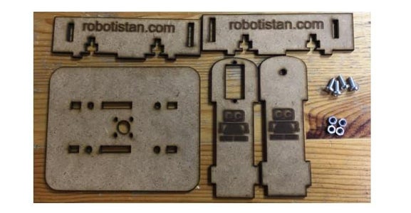

The numbers of the wooden sections are displayed in this figure. In the next stages, we will describe which portion to use and how to use it in this manner.

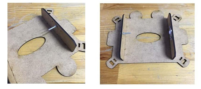

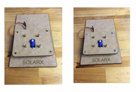

Step 3: Lower Body Assembly - 1
First of all, we will assemble the servo motor in the number 1 part. Mount it using the two long screws that come out of the servo motor package.
Step 4: Lower Body Assembly - 2
After that, you can mount the servo motor with "4 10 MM" spacers and 4 nuts to the part number 1 where we mount it. These spacers will help the upper body to rotate more stable.

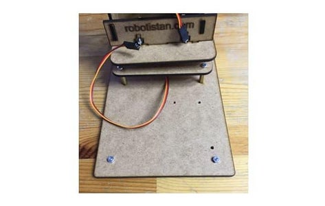

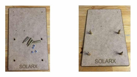

Step 5: Lower Body Assembly - 3
To raise the part number 1 from the bottom plate, you should mount 4 20 MM spacers using 4 nuts.
Step 6: Lower Body Assembly - 4
And the next step is to assemble part number 1 on part number 2. Mount the part number 1 to the "20 mm" spacers on the part number 2 by using "4 6 MM" bolts. After this step, the assembly of the Solar Tracker's lower body will be finished.

The parts numbered 3, 4, 5, 6, and "4 10MM" bolts, respectively, are necessary for the assembly of the first portion.

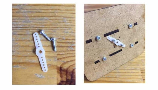

Now you can mount the servo head that comes out of the servo motor package to the part number 4 with the "M2" bolt in the set as shown in the picture.

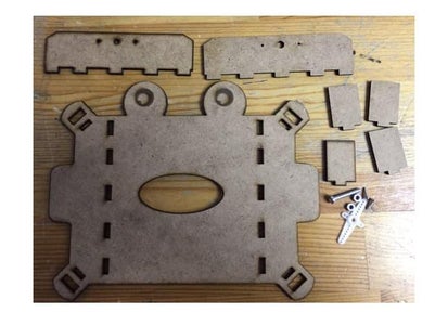

For the second section's assembly, use numbers 7, 8, 9, and 10. To screw the numbered pieces, servo cap, and M2 bolt from the set is required.
Step 13: Upper Body Assembly - 7
In the first step, fix the parts numbered 7 and 8 by passing them through the holes on the unshaped side of the part 9. The pieces can cross each other a little hard, so don’t worry. Just push the part in, not too much :)

After fixing parts 7 and 8, you can mount the servo head to the part number 8 with the "M2" bolt in the set as shown in the picture.

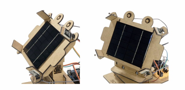

The first and second parts will be combined in this stage.
We pass the "15 mm" bolt to part number 7 through the hole on part number 6 and mount them with a nut, as shown in the picture. Please do not overtighten this nut.
Because if you squeeze it too tightly, it will be unable to move freely up and down. Then we screw the servo head in part 8 to the servo motor in number 5 with the little screw that came with the kit.

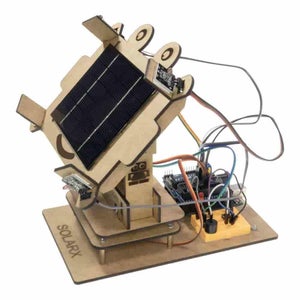

As the last step of the mechanical installation, fix 2 "6 mm" bolts with 2 nuts to the part number 2 as shown in the picture. The reason we do this is because solarx stays still on flat surfaces without wobbling. After this step, the assembly of the mechanical parts will be finished.

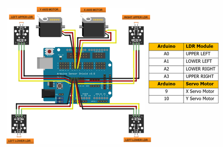

Using the following schematic and connection table, you can link LDR and servo motors to Arduino Shield. Pay carefully to the LDR modules' directions as you make your connections. Your solar panel will otherwise spin in the other way.

Our project is now ready!
Step 23: Conclusion
You have successfully completed the Solar Tracker Project!
