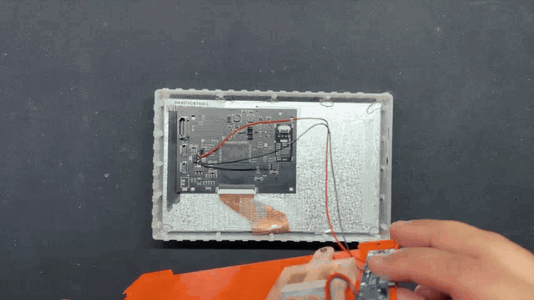

Step 7: Display and Power Circuit Assembly
The display's driver circuit does not provide a 5V output for powering the panel. This was challenging, but we resolved it by connecting a USB cable to the Power Micro USB port, then using a multimeter in continuity checking mode to find out that the 5V pin is connected to the IN port of a voltage regulator.
  1. We soldered a connecting wire between the voltage regulator's IN port and the 5V power circuit. GND was linked to the voltage regulator's GND terminal.
  2. When we switch on the circuit after soldering, the screen illuminates, indicating that our setup is operational.
Step 8: Frame Assembly Process
  1. We start the frame assembly process by placing the display in its proper location inside the frame enclosure.
  2. We use hot glue to secure the display. Hotglue will keep the display intact, so apply it to all four corners, including the midpoints between corners.
