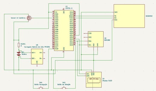

Step 1: Circuit Assembly
As shown in the attached figure.
The UV module is connected to the Rx and Tx pins of the ESP32.
The BMe280 sensor and the OLED display are connected to pins IO21 for the SDA port and IO22 for the SCL port.
The UV sensor is connected to pin IO02.
The pushbuttons are connected to pins IO18 and IO19, as well as GND.
The positive output of the battery is connected to a 10K resistor, which in turn is connected to the VIN and IO34 pins of the ESP32.
The battery charger is connected directly to the battery.

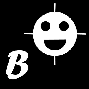

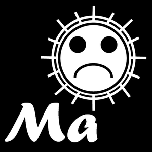

For the iconic characterization of the UVI, icons were established with the drawing of the sun, with various expressions, as shown in the attached figures, and the initial letters of the categories, in Portuguese.
Thus, on the main screen, we have the UVI classification by number, on the left, and the representation by icon on the right.

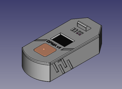

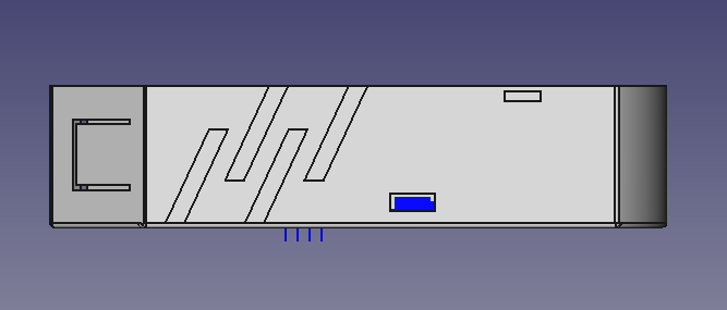

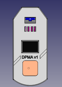

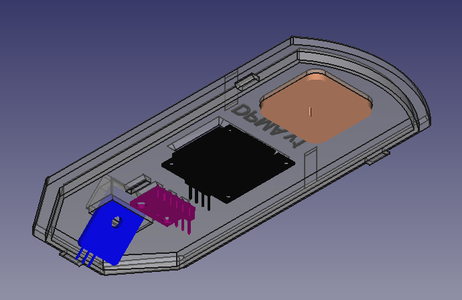

The structure was designed in FreeCAD and strives for maximum portability.
It is a rectangular object measuring 13cm x 5cm. It is easy to handle and can be carried in a small waist bag.
The connections between the components are made using female-to-female jumper cables.
The electronic components must be glued directly to the structure, partly on the body and partly on the lid.
The structure is divided into a body and lid, and there are two versions of the body: one for those who want to use a CR2032 battery and another for those who want to use a rechargeable 3.7V lithium battery.
The parts are available for 3D printing in PLA.
The attached images show the arrangement of the components in the structure.
