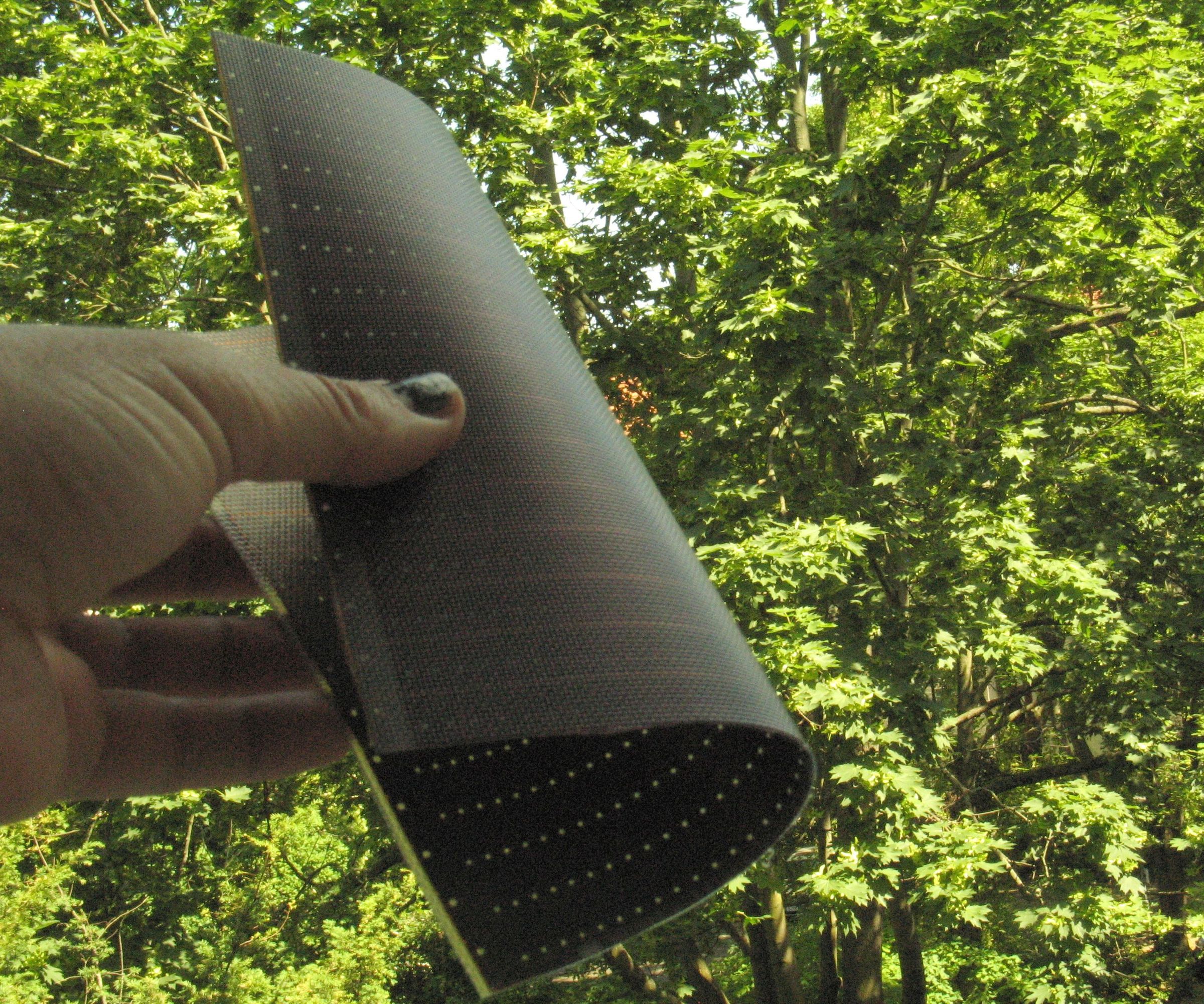

Before I started writing this instructables I searched to see what other people have done, and of course we are not the first to think of using an old tft screen for our project. A TFT screen is in essence a lightbox with a tft board in the front. So removing the board (and a few polarizing sheets) will leave you with the lightbox.
Here is a similar attempt. The advantages of TFT screens are numerous:
a) it already has an acrylic sheet and reflecting surface. And not only that, the acrylic sheet is dotted in such a way, as to distribute the light more evenly across the board.

What we need from the TFT screen, is the dotted acrylic sheet, the metal frame, and the white reflecting sheet on the bottom. And thats more or less it.

We would like to mount them on the same place where the CCFL were placed. The dotted acrylic sheet from the TFT, is dotted in such a way as to provide a uniform light from the directions the CCFL were mounted.
