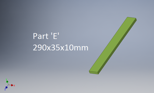

Since I don’t own the tools to cut these into straight pieces I made them do it for an extra price (actually they asked me one time and a half the price of the material), so when you will assemble the screen you won’t have problems.
In the pictures you can see the name of the pieces you’ll use and their dimensions.
For this project you’ll need:
- 2x ‘A’
- 1x ‘B1"
- 1x 'B2'
- 2x ‘C’
- 2x ‘D’
- 2x ‘E’
- 2x ‘F’
- 1x ‘G’
That was about plywood. You’ll also need plexiglass:
- 2x ‘H’
- 1x ’I’

Step 4: Base
Now you have to mount the base (follow pictures, it’s super easy).
You’ll need pieces ‘E’, ‘F’, ‘G’ and nails.
Attention: befose nailing you have to make a hole for your interruptor (and, if necessary, use a file)
Apply another layer of glue and let it dry.
