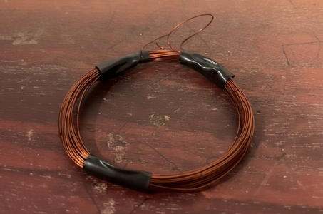

Step 1: Make the Detection Coil
The coil is the heart of the metal detector.
1.Take enamel-coated copper wire.
2.Wrap a total of 40 turns around a circular object (like a bottle, bowl, or PVC pipe).
3.Crucially, after wrapping the 20th turn (half of the total 40 turns), create a center tap by carefully stripping a small amount of insulation from the wire at that point or by forming a small loop you can later strip and connect.
4.Continue wrapping the remaining 20 turns.
5.Keep the coil tight and even.
6.Secure the coil with tape to maintain its shape.
7.You will now have three connection points:
The Start end of the wire.
The Center Tap (at the 20th turn).
The End of the wire.
8.These three ends (Start, Center Tap, and End) are necessary for connecting the coil to the PCB.

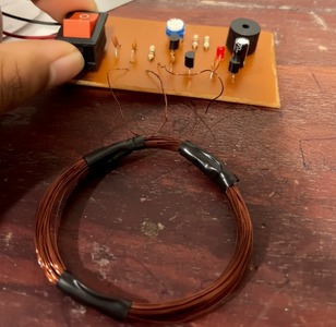

Step 2: Assemble the Circuit
On your PCB, solder the following:
  1. Resistors
  2. Capacitors
  3. A transistor
  4. Preset (to adjust sensitivity)
  5. Buzzer
  6. LED
Step 3: Connect the Battery and Switch
Connect the 9V battery snap to the terminal block.
Connect the toggle switch in series with the battery to control power.
Test the circuit by switching it ON.

Step 5: Calibrate the Sensitivity
Turn the preset slowly using a small screwdriver.
Move metal objects near the coil.
Adjust until buzzer/LED respond clearly.
