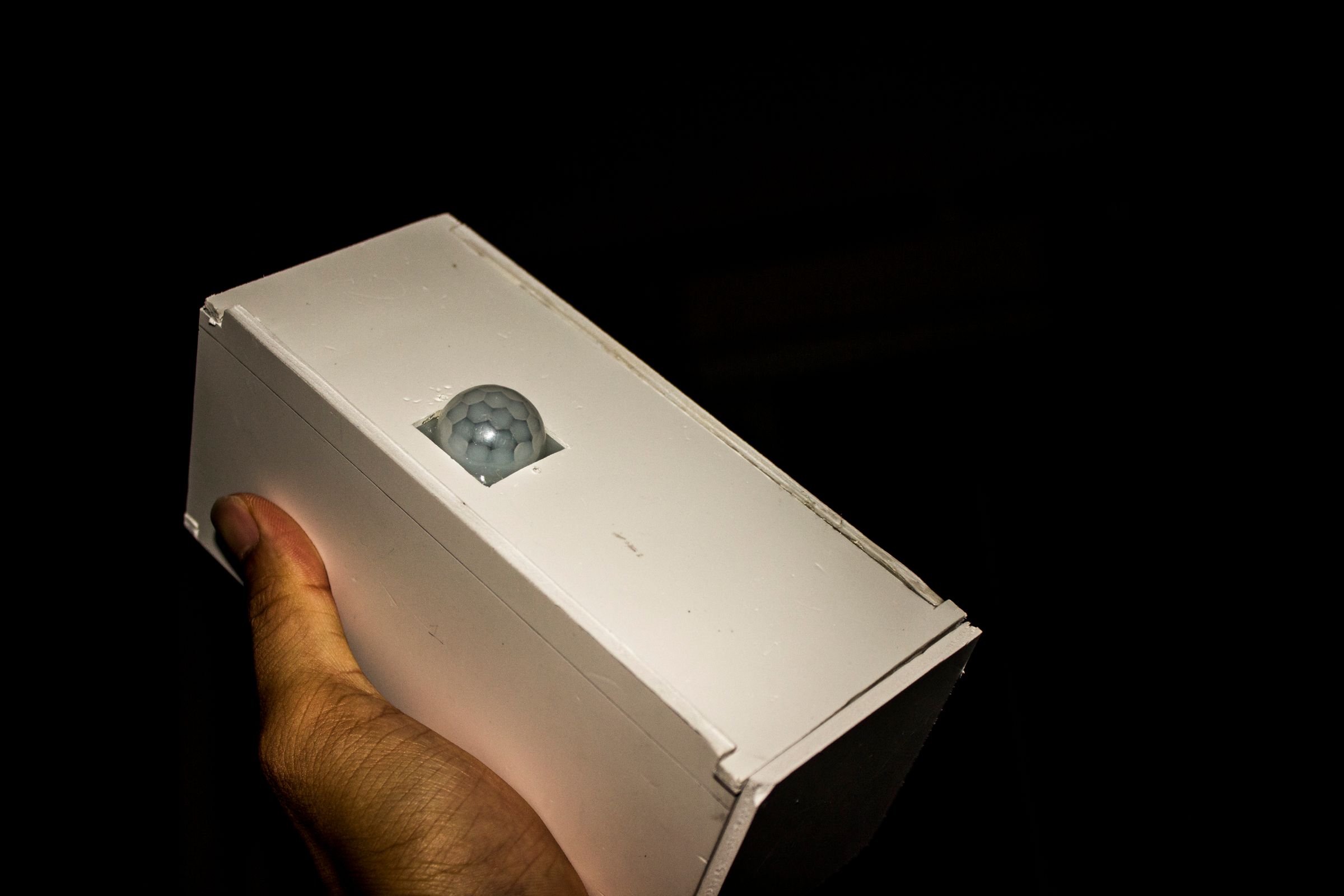

After testing our module. Now, we will put it into a Foamex case. I build a case with the following measurement: 16x7x7 cm.
I use hot glue to stick the sockets and other component to the case.
I am extremely clumsy so the wires look terrible.....
