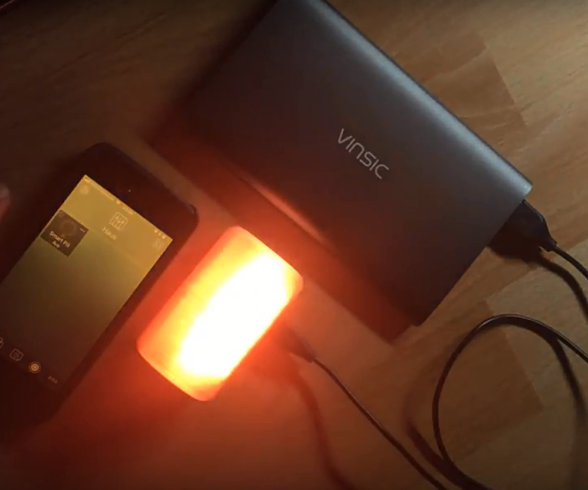

Perhaps you've been on travels or trips and have thought: 'I wish I could carry this as well, oh.. and this as well.' Don't worry, I'm the same :). Travelling can often be time-, and memory-consuming (from taking pictures and videos) so to tackle that boredom and the lack of memory, the best solution I came across was a compact and portable cloud, which works offline. While most cloud-storage's are chunky, other online-clouds rely on a internet connection. Both don't seem like good solutions for traveling so I decided to go with a portable, offline-cloud. I renamed this as the ArOZ-Online system, since the original project was also called the same (see below).
Since the release of the pi zero w, portable and connected projects including the raspberry pi have become more popular and also more compact. What if you could make your offline-cloud with just a pi zero? The form factor of the pi zero as well as the low cost make it quite suitable for this project.
This offline-cloud works by providing a wifi-signal from the pi zero w's wifi adapter. By connecting to the wifi from the pi zero, your phone, tablet or laptop is able to access the memory from the pi zero's micro sd card through a offline-website provided by the pi zero w. Pictures, videos and music can be uploaded, downloaded and played from that website. The whole system works automatically by simply powering the pi zero w.
