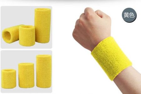

Let's build the arm band heater first. Since it will be wrapping around the arm, a good starting point would be to use an exercise/sweat band. These are meant to fit around your wrists, so they might be a really tight fit around your bicep. It should fit a little tight so it won't slip, but not too tight that it reduces circulation. A better approach might be to use an adjustable version. After a quick search on eBay, I found a couple options:
