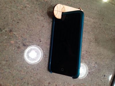

Put the wood into the laser cutter, connect the CorelDraw file to it, and let the laser go. The result should look like this.
Step 4: Keychain
You will notice that there is a small whole and the outer edge of the phone stand. This is there so that you can attach the stand to a keychain to carry around with you. The stand should now be ready to use. Have fun
