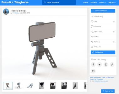

Additionally, to keep these instructions simple, I decided to 3D print the Phone Holder based on free files found on Thingiverse, as opposed to making it out of wood from scratch.

Step 11: 3D Print and Assemble the Phone Holder
If you don't have a 3D printer by now, I have no idea why you've waited so long to get one - the Ender3 I've been reliably using for the past 3 years costs less than $200. You can also order 3D printed parts online from places like Shapeways.
After browsing Thingiverse for a few minutes, I found a simple, easy-to-print design. I chose this one specifically because it's compact, low-tech (using only a rubber band for gripping the phone), and can clamp onto the 4.5" width of the plywood pieces when folded.
I processed the files in Ultimaker Cura, my favorite slicing software. Using a basic white PLA material from Amazon, it took 6.5 hours to print all three parts.
Once printed, I assembled the printed components with a rubber band.
