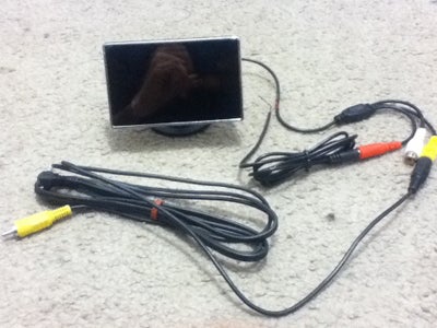

-a small 640x480 tft car backup monitor
-power jack for monitor
-a riitek mini i8 keyboard

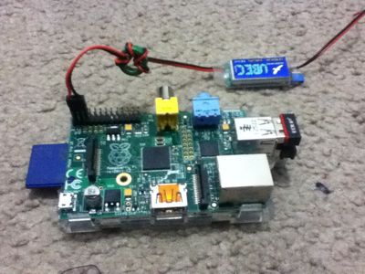

-a 5 volt UBEC module
-a male-male RCA connecting cord

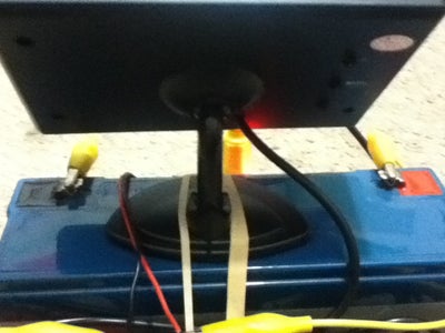

Ok, so to start off, I put the two rubber bands on the battery somewhat in the middle but a little shifted to the right. Then I plugged in the UBEC module to the raspberry pi GPIO pins, positive to pin 2 and negative to pin 6. You can check the chart to see why. Then once that's done, I slid the raspberry pi and UBEC onto the side of the battery whilst using the rubber bands to hold it there.
Step 3: The Monitor
Now onto the monitor. I plugged the power jack into the corresponding plug thingy, then I plugged in one side of the RCA cable to the yellow input jack (the white one was there in case I wanted a second input). Afterwards, I secured the monitor to the top of the battery by slipping the base in between both rubber bands. And to finish up here, I connected the other side of the RCA cord to the raspberry pi's analog output. Now in my case, I was lucky that this 12 volt car monitor was able to nicely run on only a 6 volt battery, otherwise I would have had to remove the internal voltage regulator in the monitor.
Step 4: Aesthetics
Because for some reason, no one likes loose cables and wires hanging out of their "portable" computers. So to solve the problem, I bunched up the cables and stuck them on the back of the battery with the rubber bands to hold them in place. There, problem solved.
Step 5: Finishing Connections
So here is where I finish up with the assembly. I plugged in the much needed USB wifi adapter and the receiver for the small wireless keyboard. I then had to rig up the power connections, so I hooked the power wires for both the UBEC and the monitor with one alligator clip per pole (one for negative and one for positive) so this way there would be less wires. I cannot express the utmost importance that the two gator clips DO NOT TOUCH because that would create a short circuit and on a battery this big, that would be a problem. And finally I plugged the other ends of the alligator clips to the corresponding poles on the battery and...
