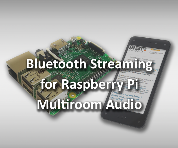

During the testing phase for our new Accesspoint-Mode Feature, I came across this cool idea and I want to share it with you guys.
A portable Raspberry Pi that you can access everywhere without a network and use as a Bluetooth receiver to stream music from your smartphone to a connected pair of speakers. I know there are a lot of Bluetooth solutions out there but this one unites the open-source nature of Raspberry Pi projects with the HiFi audio possibilities of Max2Play, without the complex coding of other tutorials.
The best thing about it: The system will remember your devices so you can access it with just one click! Everywhere! And you can pair multiple devices, for example at a party where others want to play some music with their smartphones as well.
