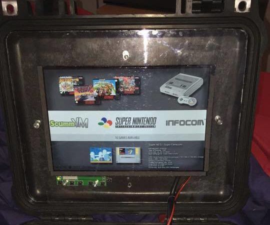

Step 2: Installing the Screen
So to install the screen you first need to measure out the part of the screen that will actually display the operating system. Usually there is a few millimeters along the edge that does not display anthing, you will use that small space to put double sided tape to and adhere to the pelican case.
Double check, no, tripple check your measurements to ensure you do not cut too large of a hole for the screen in the lid of the pelican case. If you cut too big then your screen will be much more difficult to install. When I got my measurements and I traced out the area to cut I made sure to cut the hole too small and then used my dremel to shave away little by little and checking against the screen to ensure I did not cut too much off. This is the one part that is a bit time consuming but well worth it, this is what everyone will see and if you are able to make clean even cuts and adjustments your project will look all the better for it. Also, that big rectangle you just cut out? Don't toss it, it is going to be useful for this project...
Now in the second picture you can see the back of the screen and...wait what is that?...It's the scrap rectangle I cut!!! Yes, this is what that scrap will be used for so make sure you try to cut it in one big piece instead of multiple smaller pieces. So what I used it for was to help hold the screen against the pelican case and the double sided adhesive tape to make a firm hold so the screen doesn't fall out.
BE CAREFUL when you bolt down the scrap plastic to hold the screen in place. I cracked my touchscreen on mine doing this and had to use a heat gun to remove it and disable it's touchscreen capabilities. To get around this I used washers so that the plastic was just barely above the back of the screen and then used the thin double sided tape to make up the difference and create a better hold
When you get ready to drill the holes to hold the screen down ensure you run the HDMI and power cable around (I did mine on opposite sides of the screen as it was easier) so you can ensure you leave enough space between the bolts and the screen so you can hide these cables under the scrap plastic so as to tuck them out of the way.
The final step for the screen is to mount the screen control board and the cables. This is where that piece of rubber with a sticky side comes into play. As stated in the parts list, this piece of rubber is to ensure that no shorts happen between the control board and the screen resulting in frying the board and or screen. To adhere the board to the screen I just layered the double sided tap until I got a nice flat surface and then mounted it to the rubber piece attached to the screen. Make sure to mount it low enough to allow enough space for the cables to plug in without being wedged too tightly against the case lid. To ensure proper clearance I suggest plugging the HDMI 270 degree adapter and the power cable in, but not to the power source, and then attach it to the screen. I didn't do this and had to re-adjust it several times.
Once you finish this part, the rest is much much easier.
