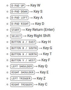

On the first boot into RetroPie, you’ll be prompted to configure your input settings. Use the keyboard to assign keys to different functions. Important: Make sure to write down which keys you assign to each function — you’ll need to remember them later for both gameplay and menu navigation. (For reference, I’ve included the key mapping I used.)
You'll use these assigned keys to navigate RetroPie’s interface. For example, the D-PAD keys allow you to move through the menus, while BUTTON A (or EAST) is used to confirm selections.

After rebooting, return to the command line and edit the retrogame configuration file to correctly map your GPIO pins to the keys you assigned earlier. Open the configuration file with:
sudo nano /boot/retrogame.cfg
You can check an example of my retrogame.cfg setup here. If you need help identifying key IDs, you can refer to the keyTable.h file in the Retrogame repository for a full list.

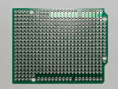

Print the PCB prototype and 6 battery brackets in PETG with 0.15mm layer height and 15% infill. Print the brackets on their sides and with supports. If you need to print the PCB at a 45-degree angle, as shown in the picture, ensure you set the fill angle to 0 in the slicer.
Attach the 6 battery brackets to the main piece using super glue.

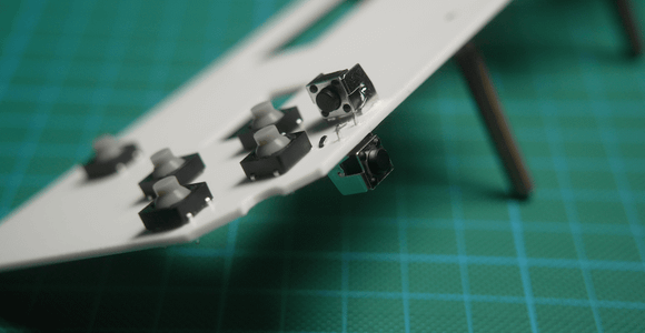

Insert the push buttons into the frame: place 4 90-degree buttons on the shoulders and triggers, and 10 regular buttons on the remaining areas. The buttons should stay securely in place. If they don’t, try reprinting the piece with adjustments to the layer thickness in the slicer.
Solder one leg (-) of each button in series, connecting them all together.
Solder the opposite leg (+) of each button to a GPIO pin on the PiSugar header, ensuring you connect them to the same pins you selected in step 3.

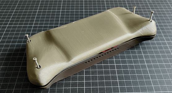

Print the case front and case back in PLA. For optimal strength and speed, I found printing them at a 45-degree angle worked best, using custom support enforcers where necessary (make sure nothing is left unsupported in mid-air) and organic supports.

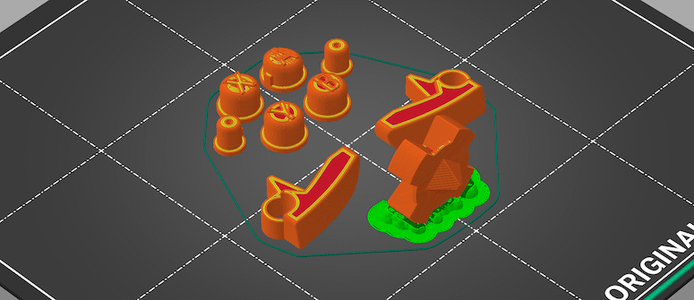

Print all the buttons together in PLA, ensuring the layer height is 0.10mm or less. I recommend printing the d-pad on its side with some supports for better results.
Insert the buttons into the front case.
Place the assembled components inside the case.
Attach the back case and secure everything with M2.5 screws. Ideally, use 16mm (⅝ in) screws at the top and 20mm (¾ in) screws at the bottom.
And that's it! Enjoy your custom Raspberry Pi handheld game console.
