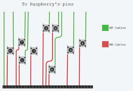

Step 1: Solder the Buttons and Cables
Solder the buttons and cables to the PCB board following the attached schem. the E, M and R buttons functions is to Exit, navigate to the Menu and Reset respectively.
Make sure to solder the male part of the MF cables to the PCB.

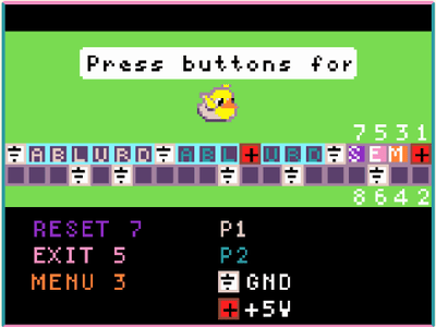

Step 5: Connect the Cables to the Raspberry
Use the first picture to connect the cables to the raspberry's pins
