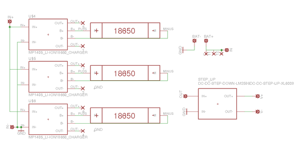

so I decided to make PCB because it has problems with overheating and soldering components together just with wires was a too long process
it is made out of three LiIon battery chargers for three 18650 batteries (you can use any Li-ion battery)
each battery have its own charger with protection circuits and if solderable jumpers are not soldered you can use each battery separately
when you connect one of these jumpers they will connect battery to battery out terminal and to the step-up converter if you add switch or jumper to switch terminal
out terminals from step-up converter are marked as 5V out because I using USB lights from eBay
but you can also use it for whatever you want just set different voltage

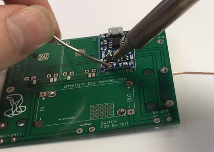

Step 2: PCB Assembly
1. cut piece of cooling (heat conductive) pad or add thermal compound under charging circuit
and solder it to PCB board using some wire in holes for better strength and conductivity
when you using thermal pad apply a little bit of pressure when you soldering first two contacts for better thermal conductivity

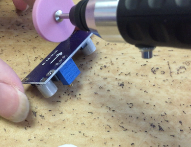

2. step up converter has pins from the bottom site which could cause a short circuit when they scratch through soldermask so is better to cut or sand them as flat as it possible if you using thermal compound add a piece of plastic or electrical tape under cutted pins for better isolation
and solder it to the board using wires as in the first step

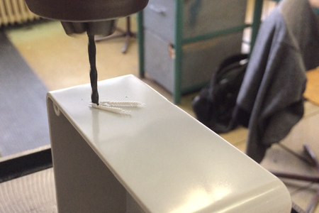

I used ordinary wall junction box, originally I wanted my box to be waterproof but one which used had bad design and water was leaking through screw holes other which I bought for the first prototype was better but after few months outside plastics start decomposing and it had a very weird smell and rough finish so it is no longer good as a portable box (it is just on surface it is common with these boxes it will last few years) this new box which I used in this instructable is made from different plastic so I will see if it will decompose same way or not
but now back to work:
if you have all components you can decide exactly where you want them always is better to make some sketches and template on paper

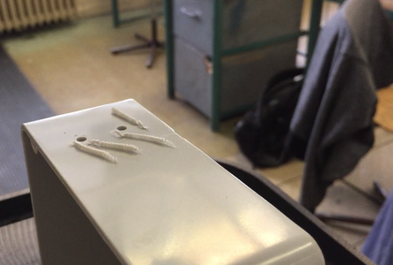

then you can punch holes with marking pin and start drilling first with smaller than with larger drill
when you using additional components use a small file to finish holes for needed dimensions
if you have all necessary holes you can put all components in and start wiring

Step 4: There Are Many Ways How to Connect It Here Is Simple Version
click for more images they contain little notes
