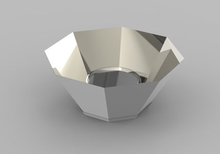

This instructable is for making a portable panel solar oven. The shape of the oven is a truncated octagonal pyramid which can be flat folded. This makes it easier to store or carry it wherever needed. I have used materials which are usually available at home.

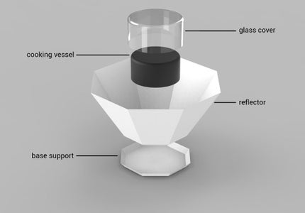

The oven is made up of mainly three parts
1) Reflector :
It is made up of 8 panels which come together to form the truncated octagonal pyramid. These panels are connected to each other such that it forms an open loop with live hinges. The live hinge gives it the ability to be collapsed into a flat structure after the cooking.
2) Base support :
It is a flat octagon with side walls which supports the reflector panels.
3) Cooking container :
It consist of two concentric glass bowls( borosilicate glass is recommended as they withstand higher temperature) the smaller bowl is painted with black paint to absorb the heat effectively. The inner bowl can be of thin stainless steel or aluminium as long as it is coated with black color. The gap between the outer and inner bowl acts as the greenhouse that traps the heat.

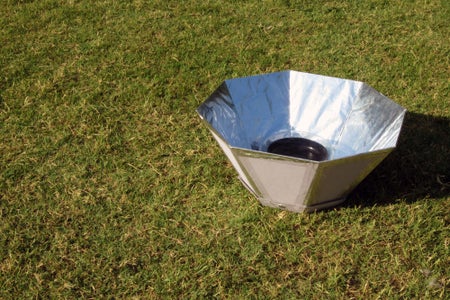

Step 5: Cooking Vessels
I have used two Borosil bowl of different sizes such that the smaller on fits inside the bigger but a gap of approximately 15 mm.
Note : Borosilicate glass is recommended as it can withstand higher temperature.
Dimension of outer bowl (1500ml) : dia - 159mm, height - 94mm
Dimension of inner bowl (800ml) : dia -132mm, height- 78mm
here is the link
For the inner bowl you can use any aluminium or stainless steel vessel with a lid.
You need to coat the inner vessel with black colour to absorb the sunlight effectively. Make sure the paint you use is non-toxic as it is going to be very close to the food.
The arrangement of the vessels is shown in the second image. Make sure the lid of the inner vessel is not air tight as pressure might build due to water vapours.
