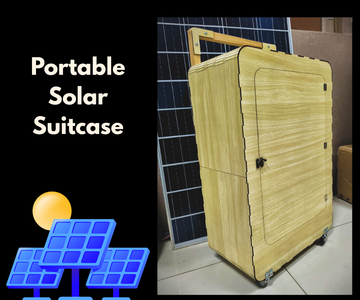

A compact, foldable solar generator built inside a laser-cut suitcase-style body
In this project, we’ll walk through the making of a portable solar generator, designed as a suitcase-style system that’s both compact and functional. Whether you're powering devices outdoors, at a remote campsite, or during emergencies, this solar suitcase makes clean, off-grid power practical and portable.
Built using laser-cut MDF panels, foldable solar panels, and Li-ion battery storage, this system offers multiple output ports (USB, DC, AC) and includes a charge controller for battery management. You can customize the size, capacity, and port options to fit your specific use case.

Step 1: Laser Cut the Suitcase Body
We started by designing the body using RDWorks software and laser cutting the components out of MDF board. The suitcase is modular and sized just enough to house batteries, controllers, and wiring, while keeping portability in mind.
The file used for laser cutting are attached below.
We used a 3.3mm thick MDF Board for this project.
Tip: Use tabs and slots to ensure tight-fitting joints and reduce glue usage. After cutting, sand the edges for clean assembly.
Step 2: Assemble the Main Structure
Using the laser-cut panels, we built the box using super glue and screws where needed.

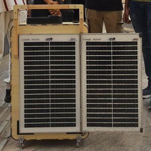

The back portion houses the foldable solar panel mounted using small hinges, while the bottom half includes the battery compartment and the charge controller.
We attached wheels to enhance portability.
Make sure to leave space and make holes for wires.

Step 4: Testing and Finishing
Once the circuit was verified, we closed the case, connected the solar panel to charge the batteries, and tested the output.
We were able to get around 22 volts in direct sunlight, while got around 18-20 volts in indirect sunlight.
The system can be used to power LED Bulbs, mobile phone, laptop and a small fan with ease.
For aesthetics, we polished the MDF, added handles, and made the setup easy to carry.
You can add labels, paint, or even vinyl wrap to personalize it further!
