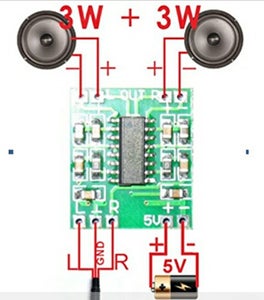

The circuit is very simple just hook up two wires to the vcc 5V and ground pin of the amplifier ic
connect one speaker to the one channel output name +L -L and other to +R -R, these are the output to our speakers
TO connect input to the amplifier,strip off a aux cable from one side and carefully strip 3 signel wires, to check which wire is ground put the multimer on continuit mode and attact one lead to ground pin and other to 3 wires one by one, the wire which will produce a sound is the ground wire
Now carefully solder the wire to the ground input point and other to left and right channel inputs( attach any input pin to either left channel or right channel input it doesn't matter)
Now our circuit is complete so test it using a 5v dc supply to input and playing music

solder the components according to the described schematic

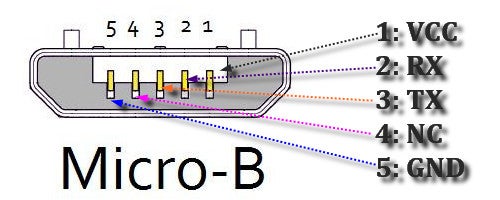

You can use tis circuit directly with any standard 5v supply or by using a microusb female adapter(like i did).
I salavaged a micro usb female jack from a old powerbank and ued its casing for protective casing of the female jack ( as it is very fragile)
to salavage a old powerbank circuit simply remove the battery and put +ve wire on the positive end of the battery connector of powerbank and -ve to the negative end of the battery. I have removed the battery to save some space
