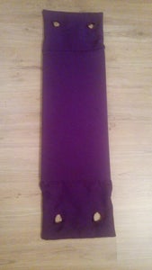

* Enough textile ( something you don't use anymore think green!, But if you're not sure lay the textile 4 time's on each other so you'll have a strong base and the textile will not tear if you'll sit on it ) [PICTURE 1]
* Wooden plank ( I used a MDF plank, 12mm, Again think green! but make sure it's strong enough ) [PICTURE 1]

So the first thing to do is to put you're wooden plank on the needed textile and measure the length you want for you're swing. The Wooden plank that i used is a little bit more the a normal chair sitting length. You use your chalk to denote where you need to cut the textile.
Then, if you cut the piece of textile you needed you will fold it together 4 times, this will make a strong base so the textile will not tear if you sit on it.

Now we will sew the length of the textile and make a bag so we can put the wooden plank in it later. Make sure the wooden plank will fit so be mindful. [ PICTURE 1 & 2]
Then we will put the wooden plank on the textile and measure the two end so they are the same. You can use you're chalk ore use some thumb tacks to denote the place you'll need to sew. this is for one side so we can put the wooden plank in the bag. [ PICTURE 2 & 3 ]

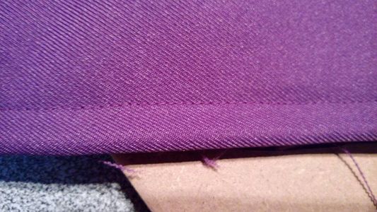

Now we will put the wooden plank and put it in the bag, make sure you'll chamfer the contour of the plank because it can let you're textile tear when you swinging.
Now the wooden plank is in it's place we can sew it again so the wooden plank can't move anymore, you know if you want you can attach a zipper and after use you can pull of the textile and wash it. [PICTURE 1 & 2]
Then we will sew the last end so the swing is closed [PICTURE 3]
