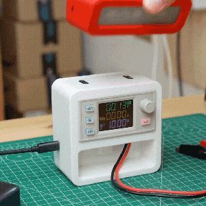

Now that we have the two 3D-printed parts that make the enclosure, we can start assembling our lab bench power supply. First I installed the digital voltage regulator, which snaps in place in the front opening. Then came the USB-C Power Delivery trigger board, which can be secured with some hot glue in front of the opening for the USB port. This board is essential for this project, because it allows us to choose what voltage we want to receive from the USB-C power supply, starting from 5V and going all the way to 20V. After connecting a USB-C power supply to the trigger board, by pressing the button I selected the output voltage of 20V, which is perfect for powering the voltage regulator module. It is worth mentioning that not all power supply can deliver up to 20V, but in that case the board is going to negotiate the highest possible voltage, that can be 9, 12 or 15V.
After the USB-C PD trigger board was set up, I used two pieces of AWG 16 wire to connect the + and - output terminals of the trigger board to the input terminals of the voltage regulator. At this point the screw terminals of the voltage regulator will not be easily accessible, but remember that they can be pulled out thanks to a built-in connector.

The main innovation of this project is the ability to add modules on top of the lab bench power supply, expanding its capabilities and creating a fully portable electronics station. For example, I created a work light as a module that snaps on top of the power supply, to have our work area always well-lit even in dark environments. These modules work thanks to a set of magnetic pogo pins I added on the top of the case of the power supply. These connectors not only give power to the modules, but also keep them secured to the power supply and give a really nice feeling when installing them.
Step 5: Magnetic Connectors
For this project we need two pairs of magnetic pogo pins, each one with two pins for positive and negative. Two connectors of the same type will be installed in the power supply case, in the two slots on the top. I connected the two connectors together with some wire, keeping in mind that they will be installed with opposite orientation. To avoid mistakes, I set the scheme of round side of the connector going to the positive and square side of the connector going to the negative. Installing the two connectors with opposite orientation will allow us to install the modules in both directions, without the risk of inverting the polarity. To one of the two connectors I also soldered two wires that will be used to give power to the connectors. After protecting the soldered joints with some heat-shrink tubing, I placed the connectors in the two slots, and secured them with hot glue. The two wires go to the positive and negative output terminals of the USB-C Power Delivery trigger board, where the input of the voltage regulator is also connected.
Lastly, I could close the back panel of the enclosure, using four black M3 countersunk screws.

Now comes the best part: snapping the lamp on top of the power supply with the magnetic connectors. Apart from the amazing feeling given by the magnetic connectors, the lamp itself works really well, effectively illuminating the work area in front of the power supply. On top of the lamp we have a small tray that is really useful to put screws in when we are opening some electronic device. The lab bench power supply itself also works well, allowing us to adjust voltage and current using the buttons and the know while seeing the values on the display. The display also shows useful data like the current draw of the connected load. By doing some tests using a multimeter, we can say that the voltage adjustment is definitely precise enough for most use cases, while the current limiting has an offset of a few milliamps, which generally isn't a problem either. The opening on the front can be used to store the output cables of the power supply, and on the back it has a hook to secure them with a velcro tie to keep them neat and organized. The ability to power the whole lab bench power supply from a single USB-C cable makes it the perfect tool to use on the go, connecting it to the power adapter of our phone or laptop or even to a USB-C power bank.
