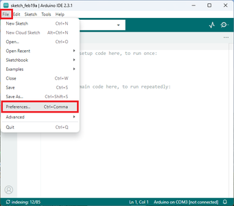

1. In your Arduino IDE 2, go to File Preferences.
2. Copy and paste the following line to the Additional Boards Manager URLs field.

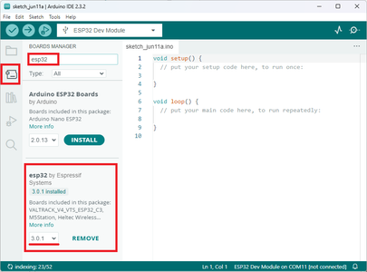

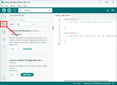

3. Open the Boards Manager. You can go to Tools Board Boards Manager… or you can simply click the Boards Manager icon in the left-side corner.
4. Search for ESP32 and press the install button for esp32 by Espressif Systems version 3.X.

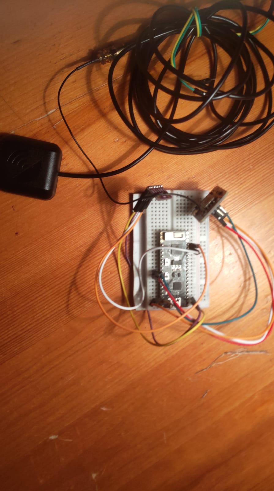

Step 4: Assembly of the Project Scheme
Now unplug your ESP32 from your PC or laptop.
  1. Conection of GPS NEO-6M
GPS NEO-6M --- ESP32
VSS ----------------- 5V
GND ---------------- GND
RX ------------------- 14 pin
TX -------------------- 12 pin
  1. Conection of BME280
BME280 --- ESP32
VSS --------- 3.3V
GND -------- GND
SCL --------- 22 pin
SDA --------- 21 pin

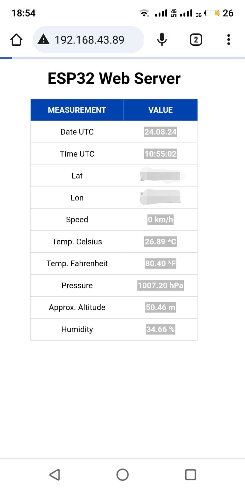

At serial monitor you shoold see web server IP adress.
Copy and paste this ip adress to your browser (you must be conected to the same network with esp32)
After this steps you shoold see your location, humidity, temperature, altitude, time, date.
