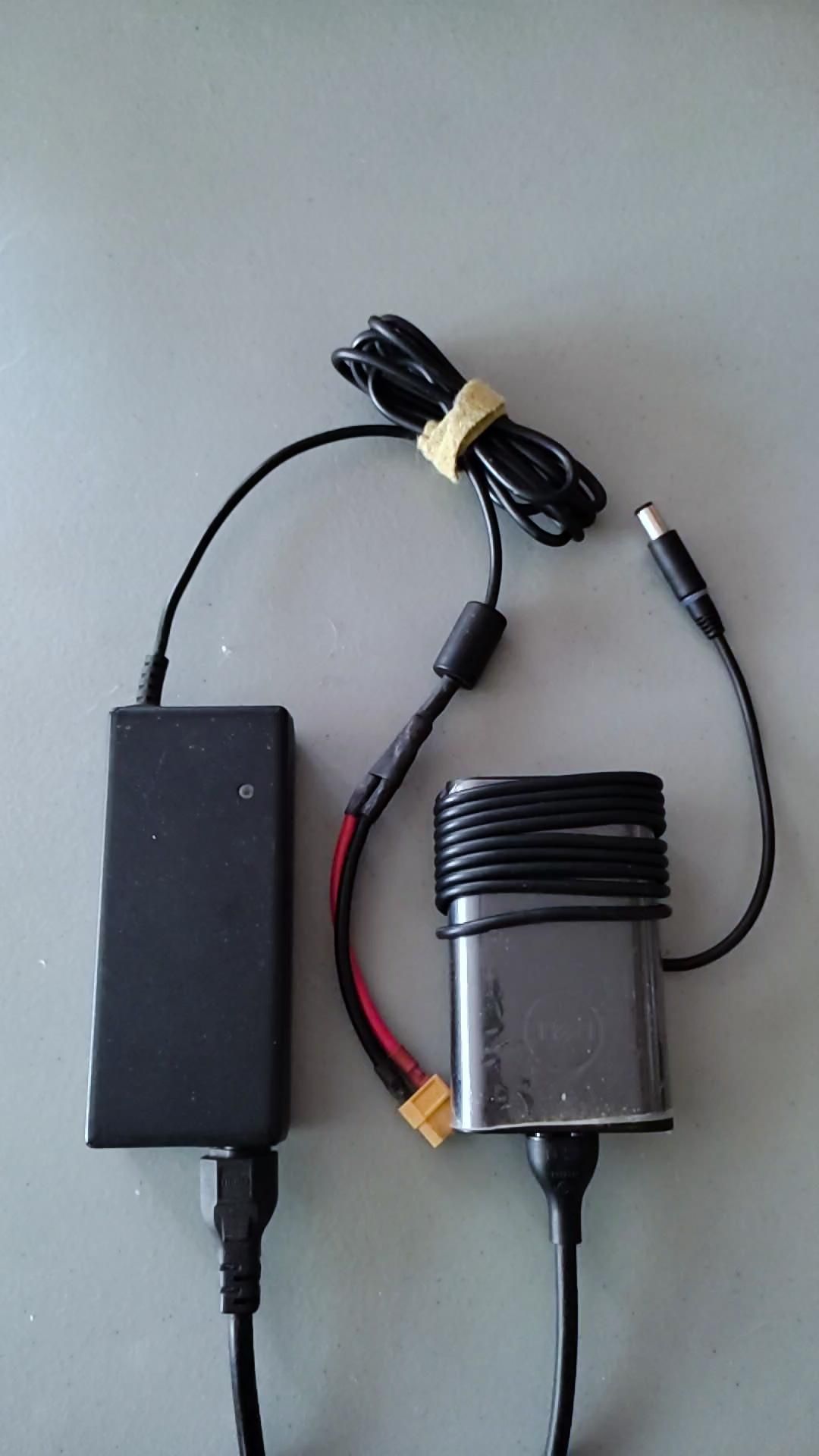

CHARGER
No solar panel or no sun but you get it charged? You can repurpose an old laptop power brick
https://www.instructables.com/Laptop-Power-Brick-Adaptor-for-Your-LiPo-Balance-C/
