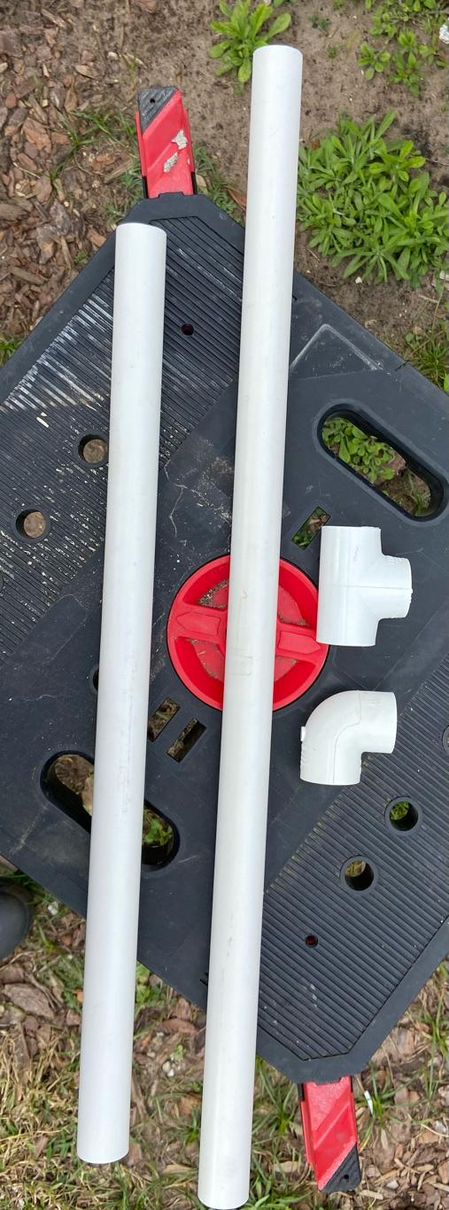

  • First, cut two of the 10 foot sections into five 24 inch long sections each.
  • Next, cut the last 10 foot pipe into four 30 inch sections.
You should now have 12 short pieces of PVC pipe.

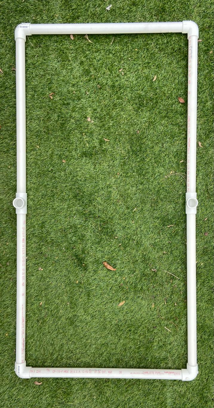

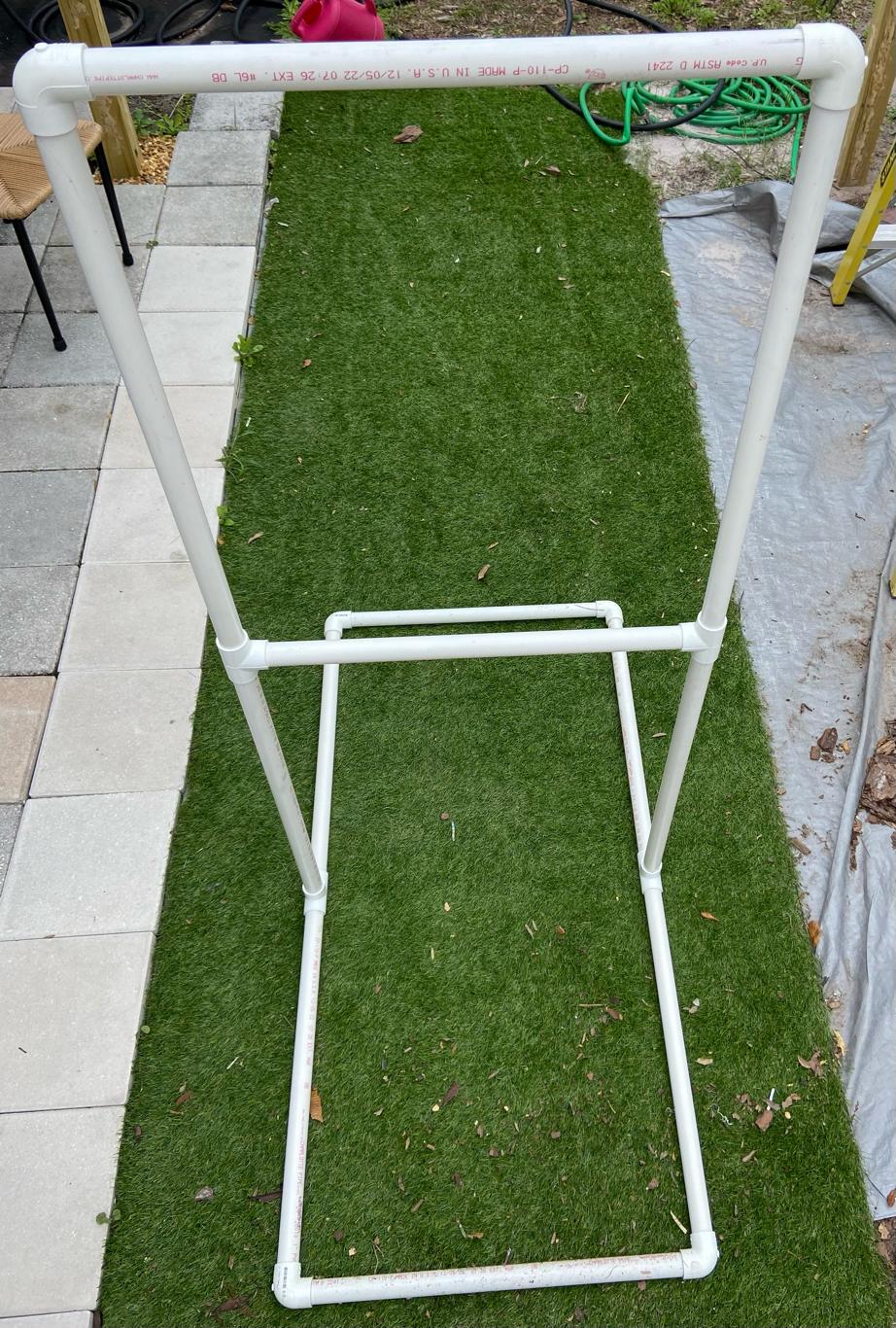

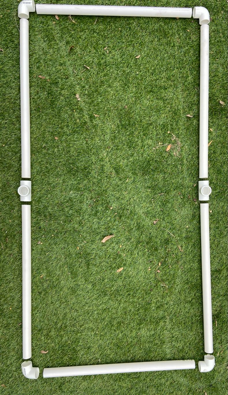

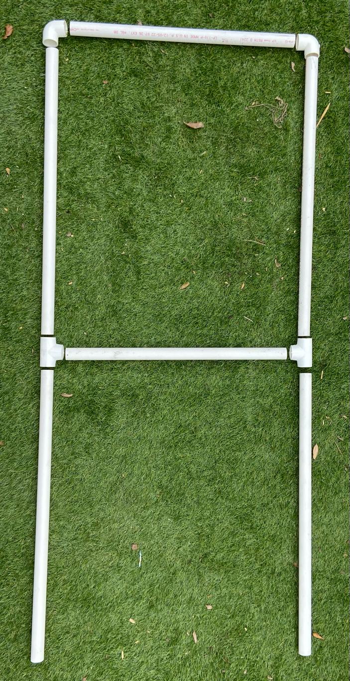

Assemble the PVC sections and fittings according to the photos. The four longer sections of pipe determine the height of your target stand. The sections filled with your weighted material form the rectangle that rests on the ground and supports the vertical portion of the structure.
