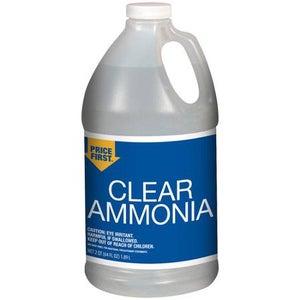

Before we take off, it might be important to inform you that
there are 2 ways of bending balsa wood. The first way is by using a steam gun. The second way is by using ammoniac and hot water.
I used the second way because I hadn’t a steam gun. This technique is very easy, but dangerous because you work with pure ammonia. Ammonia is a toxic material that corrodes the eyes, so always wear safety gear, most importantly safety glasses to protect your eyes!!! I could fix it at my school, but if can’t get it, you can always use cleaning products based on amonia, like cilit bang.
The proportions are 1/3 ammonia and 2/3 hot boiling water. The longer you put your balsa wood in the liquid, the easier it is to bend.

I’m soaking the wood in the ammonia mix/liquid for about 10 minutes. The time depends on the thickness and the density of the wood. The proportions are 1/3 ammonia and 2/3 hot boiling water. The longer you put your balsa wood in the liquid, the easier it is to bend.
To give you an idea. My piece had a thickness of 2 mm and after 10 min it was ok.

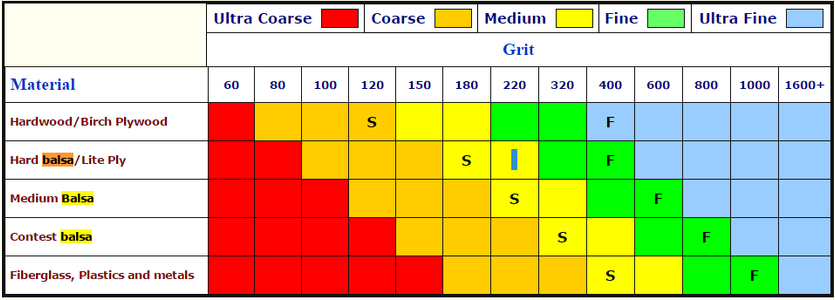

Step 9: Finishing Touch
I used some grinding paper to give it a good look.
You can see what grid to use in the table above. I need to be gentle cause balsa is really soft.
