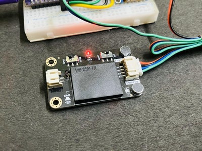

Step 4: Circuit Diagram for Breadboard Testing:
For the testing purpose we are using a breadboard setup, on which Display SSD1306 is connected via the same I2C port in which Module is connected. I2C supports up to 127 devices with different addresses. Whole the system is powered directly by the USB power from the Arduino. A LED is also connected with Digital pin 2 of Arduino Nano. The code can be programmed as per 2 devices here functions to ON/OFF the LED and display some number on SSD1306 display. GND terminal of all the peripherals remains common.

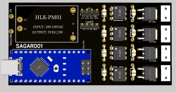

Step 6: Circuit Diagram of Smart Solid State Relay:
Here I choose D2, D3, D4 and D5 GPIOs of Arduino Nano to control with this module over voice commands, all the 4 GPIOs are connected to a solid state relay module and code is given below. Whenever a change in voice command are required then modify the following lines accordingly:

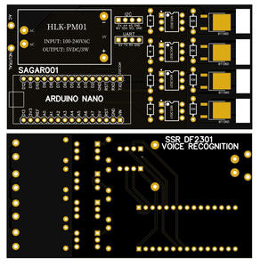

Step 7: PCB Designs:
The PCB is designed as per small load configuration, usually BT136 TRIAC can handle a max of 600v @4A of continuous current. Which is enough rating for a small load, but I will always recommend to use the PCB with loads below 300W. Because the TRIAC is mounted on the PCB itself, the heat dissipation capability is a little bit less.
The Arduino and controlling section is placed one side and AC mains one side the design has an onboard 5v module which can be placed to power the Arduino and module. Pin headers are given for the offline module to connect over I2C or UART. This project contains AC power supply and handling with AC 220v is dangerous without proper knowledge of circuitry. Follow the below given diagram to connect any load to this PCB.
