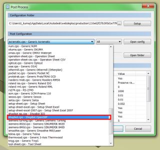

3) In the window, click Setup in the top right corner.
4) Select Generic Posts.
5) Under Post Configuration, choose Shopbot.cps--Shopbot Open SBP.
Step 1:
Step 2:

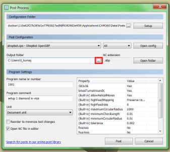

6) Insert a USB drive into your computer.
7) Click the three dots to the right of Output folder to map the output to another location.
8) Navigate to your USB drive, and click Open.

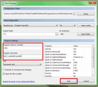

9) Under program name or number, type 1001--it must be four digits, and only digits.
Because you will have multiple programs, organize them such that Tool 1 goes with program 1001, Tool 2 with 1002, and Tool 3 with 1003. This will keep you organized.
10) Under program comment, write something useful like "Tool 1 pushstick pocket."
11) Click Post.
12) Click Save to save to USB.
