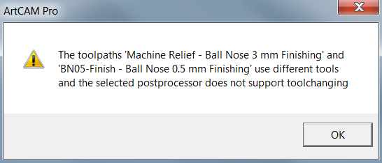

If toolpaths containing different tools are passed over to the right hand window of the Save Toolpaths form and the selected Post Processor does not support an Automatic Tool Changer then a box with an error message will appear.

The operation has failed and the above error message appears. The files were unable to be processed for two reasons.
- The selected Machine (post processor) does not support tool changing itself.

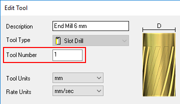

- All tools are currently identified as Tool number 1. The Tool Number is essential to identify the location of an individual Tool in the tool changer or carousel.
The Tool Number can be specified in a number of ways.
- Entering the tool number within the defined tool of the toolpath. The Toolpath must be recalculated.
- Entering/Editing the default tool number defined in the Tool database.
- The quickest way is to change the tool number by first highlighting the tool in the Toolpaths Project Panel.
- Then changing the Tool number in the lower window before selecting Apply.

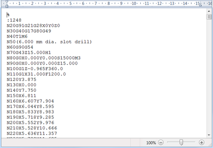

NC code can be viewed in WordPad for analysis or editing if required.
12 Right mouse click on the Toolpath Machine Ted an open with WordPad.
The outputted NC code can be viewed.
