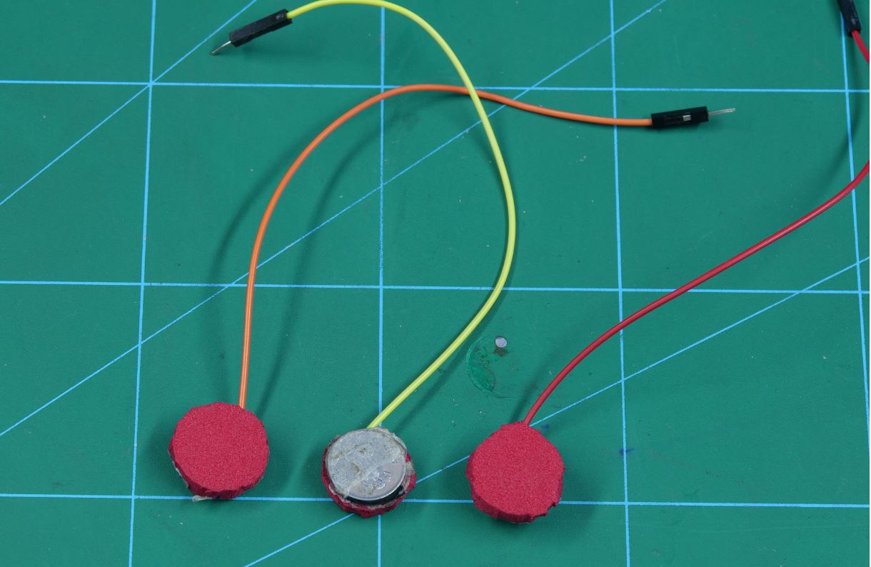

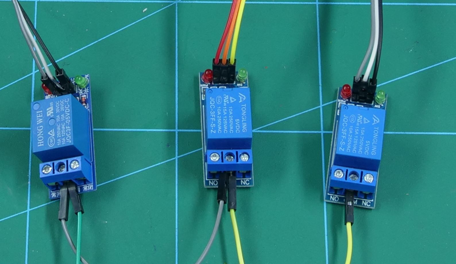

We will be using the assembly of coin and relay to generate the touch.
As we know that the relays work as switches. We are going to need three relays.
Once you have all the three relays, connect the GND of all the relays together.
We need coins to attach them on our screen of the Smartphone, where we need to attach the coin to the screen.
Take the coin and attach the Jumper Cable using soldering as shown in the figure. You can also decorate it if you want.
Connect these coins to their respective relays as shown in the figure.

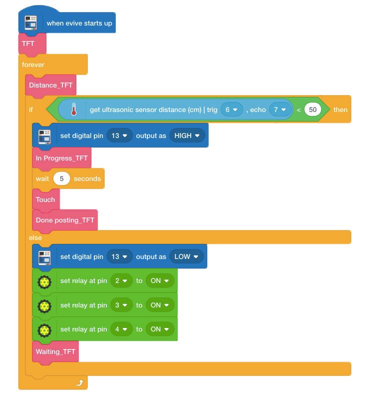

Step 5: Working
The coins that are fixed on the screen are used to generate the touch on your Smartphone. The logic behind the touch screen is that, once you touch the screen the charge from your body are transferred and then complete the circuits. Here we have used coins attached to the relays to complete the circuit.
The ultrasonic sensor is used to trigger the entire event. We have placed the coins where we need the touch to be generated.
1. For opening the camera
2. For Capturing the photo
3. For Posting the photo on Instagram
Thus as soon as the signal is sent via ultrasonic, the process of capturing the photo and posting it on Instagram starts. The relay connected to the particular touch will be set High completing the circuit, thus generating the touch.

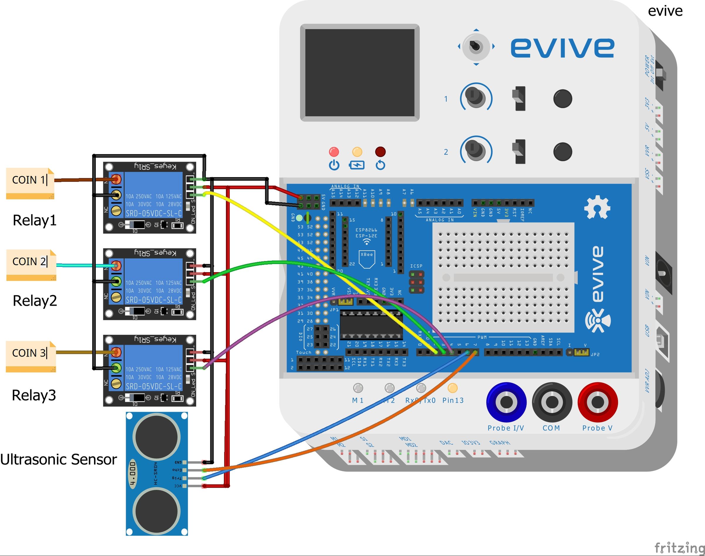

Step 6: Making the Connection With Evive
Make the connection as given below:
- Firstly connect the jumper cables attached to the coin to the Normally Open pin of the relay.
- Make the GND pin of all the relays common and attach it to GND pin of evive.
- Connect the VCC pin of all the relays to +5V pin of evive.
- Connect the signal pin as:
- Relay 1 - Digital pin 2
- Relay 2 - Digital pin 3
- Relay 3 - Digital pin 4
- Connecting the pins of the ultrasonic sensor:
- GND - GND
- VCC - +5V
- Trigger - Digital pin 6
- Echo - Digital Pin 7
Connect it as given in the below figure:

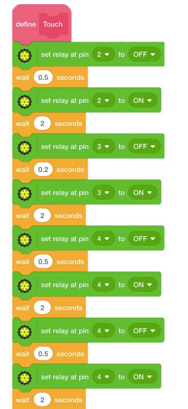

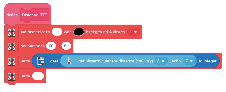

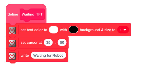

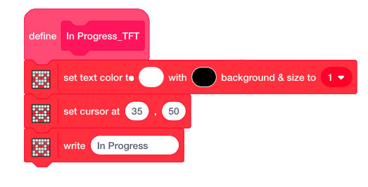

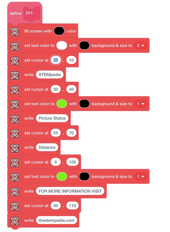

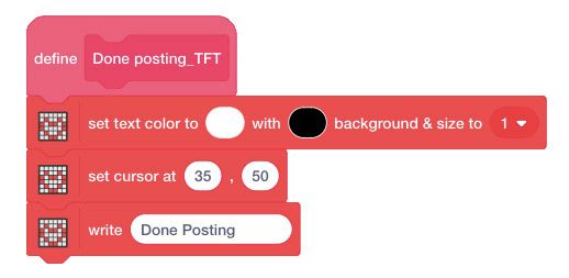

Step 7: Writing the Script
Write the script as shown below and upload it to evive:
