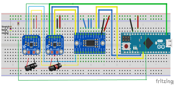

1.     Arduino micro
2.     Supply cable for Arduino (micro-USB to USB-A)
3.     Breadboard
4.     Electric cables suited for breadboard
5.     Multiplexer
6.     2x Adafruit DRV2605L (motor drives)
7.     Tachammer: 1x Drake LFI; 1x Drake LF
8.     T-shirt
9.     Conductive rubber cord stretch sensor
10.  4k7 Ohm resistor

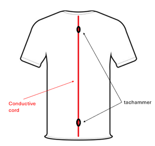

Step 1: Preparing the Fabric
To detect bad posture, a conductive rubber cord stretch sensor is attached to the fabric along the spine. The fabric should be fit tightly around the body. It is important that the two ends of the cord are well attached and the cord is not lose, to make sure that the cord will stretch when the back is hunched.
Step 2: Circuit
This circuit is based on a common multiplexer circuit with an Arduino.
Firstly, all the necessary supplies are connected (Vin and GND).
Secondly, the data line from D2 on the Arduino is connected with the SDA port on the multiplexer. Similarly, the clock line is connected from D3 to SCL.
Then the A0, A1 and A2 need to be wired directly to the ground. After that the multiplexer can be connected to the motor drives. SD1 and SC1 need to be connected to their respective ports (SDA and SCL) of the first motor drive, and similarly SD2 and SC2 to the second drive. Then the motors should be connected to the positive and negative port of their drive. Finally, the INT port of both motor drives should be connected to the D13 pin on the Arduino. This pin provides the PWM signal that is useful when using these motors.
Lastly, the stretch band resistor is connected. To be able to do an analogue reading, a resistor bridge is necessary. place the 4K7 Ohm resistor to the 5V supply on one side, and a free breadboard line on the other, connect one wire of the stretch band to this line and the other to the ground. Ultimately, place one end of a wire on the same line on the breadboard and the other and at port A5.

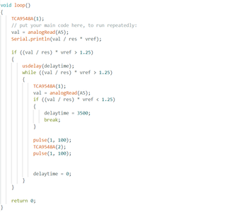

Step 3: Coding
The conductive rubber cord stretch sensor did not arrive on time while doing this project, so it was simulated by using a potentiometer. Both have a similar working principle as they measure a voltage due to change in resistance. The code is written for a potentiometer, but is almost the same as for the conductive rubber cord stretch sensor.
When a voltage above the threshold value of 1.25V is detected (bad posture), the code will do the following:
1.      The system waits for 3.5 secods specified by function delaytime.
2.      During this waiting period, if the voltage drops below the threshold (user corrects posture), the loop breaks and resets the delaytime to 3.5 seconds for the next cycle.
3.      If the voltage remains above the threshold value after the waiting period, the system enters a loop where it continuously sent out pulses that will actuate both tachammers.
4.      If the voltage drops below the threshold again, the pulses stop, and the code exits the loop, resetting the delaytime.
Step 4: Posture Corrector
If all went well, you now have a posture corrector that will alert you when your back is hunched through vibration. It is important to note that all people are different, so the threshold value is different for everyone.
