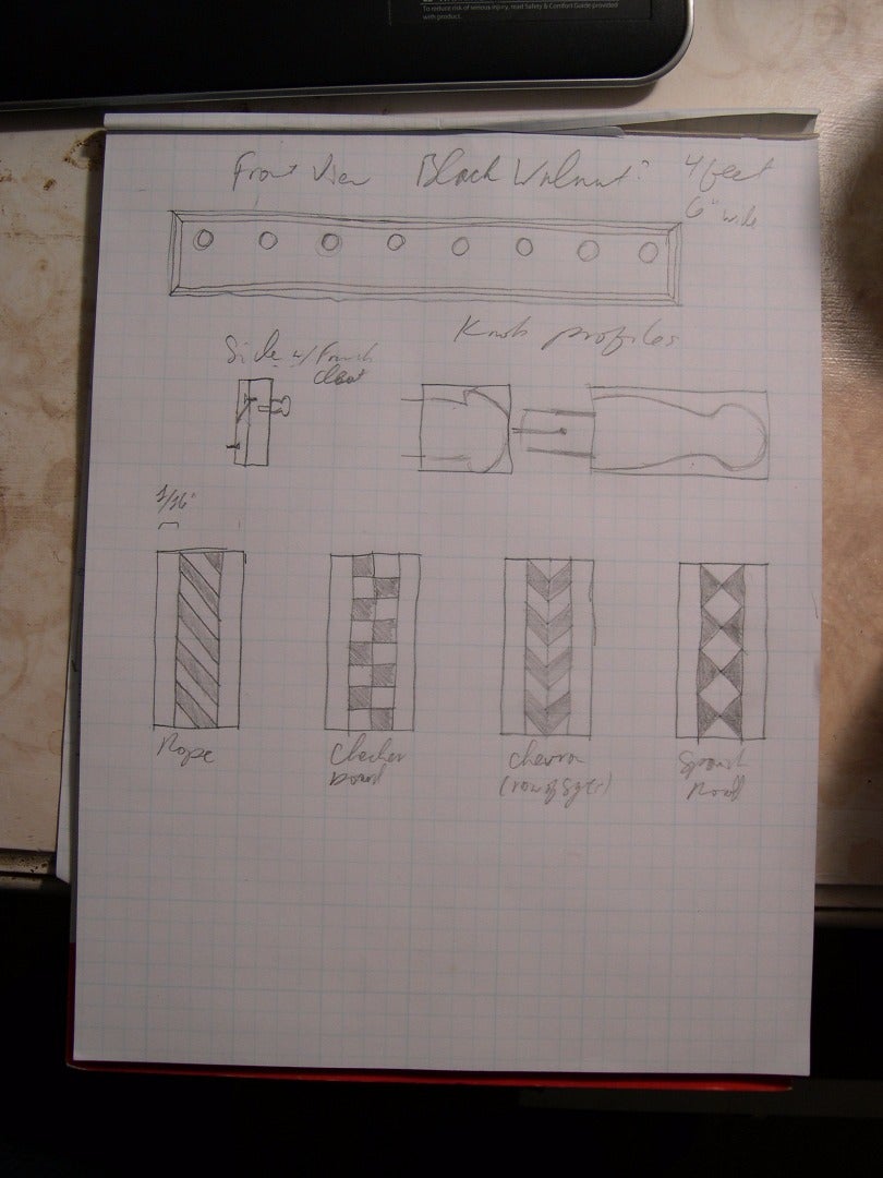

With the size of the pot rack determined, I sketched out a design detailing its overall profile, along with several shaped knobs. If I left the pot rack plain, it would simply look like a board screwed to the wall. Functional, but not pretty, and not something that a person would stop to admire. I decided to inlay banding around the borders of the pot rack to give it a little bit more detail and to dress it up.
I sketched out several banding patterns that I liked, but because I was trying to use scraps and leftovers, I went with some of the leftover banding that I had made for my dining table build.

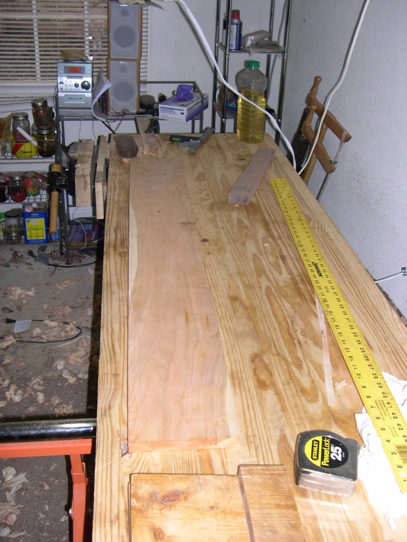

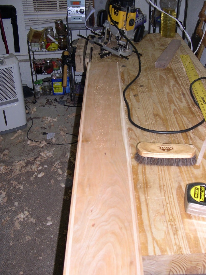

I prepared the stock by cutting the board to a 48" length, and flattened both sides with a Stanley #7 jointer plane. I then jointed one edge of the board and marked the opposite edge with a pencil to my width of 6 inches, and then planed down until I had the correct width. I then carefully squared up the ends of the board using a Stanley #4 smoothing plane.
If you purchase your wood from a big box store (and carefully pick through the stacks of wood to get straight pieces), you probably won't need to go through all the trouble of flattening and squaring it. Like I mentioned earlier, this particular cherry was a leftover from a sofa table project I made earlier that used roughsawn instead of surfaced lumber.

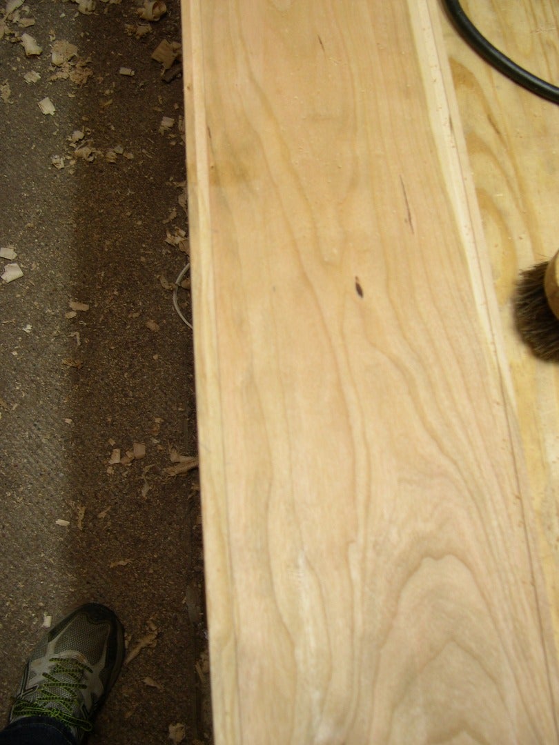

With the board completely flat and square on all sides, I measured the outside border for the banding and marked it 1/4" up from the edges of the board. I then used a piece of scrap to get the depth for the banding inlay's groove, routing at various depths and testing after each pass with the router until the inlay was sitting slightly proud. Once the depth was set, I then routed the grooves for the banding, stopping about an 1/8" from each corner and squaring the ends with a chisel.

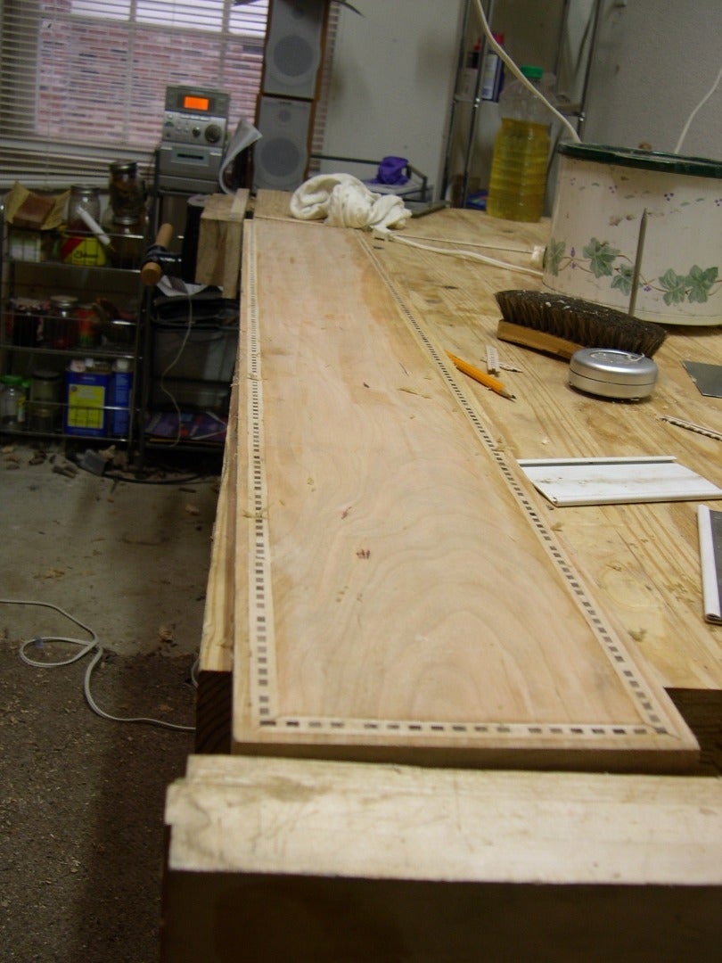

Step 3: Install the Banding Inlay

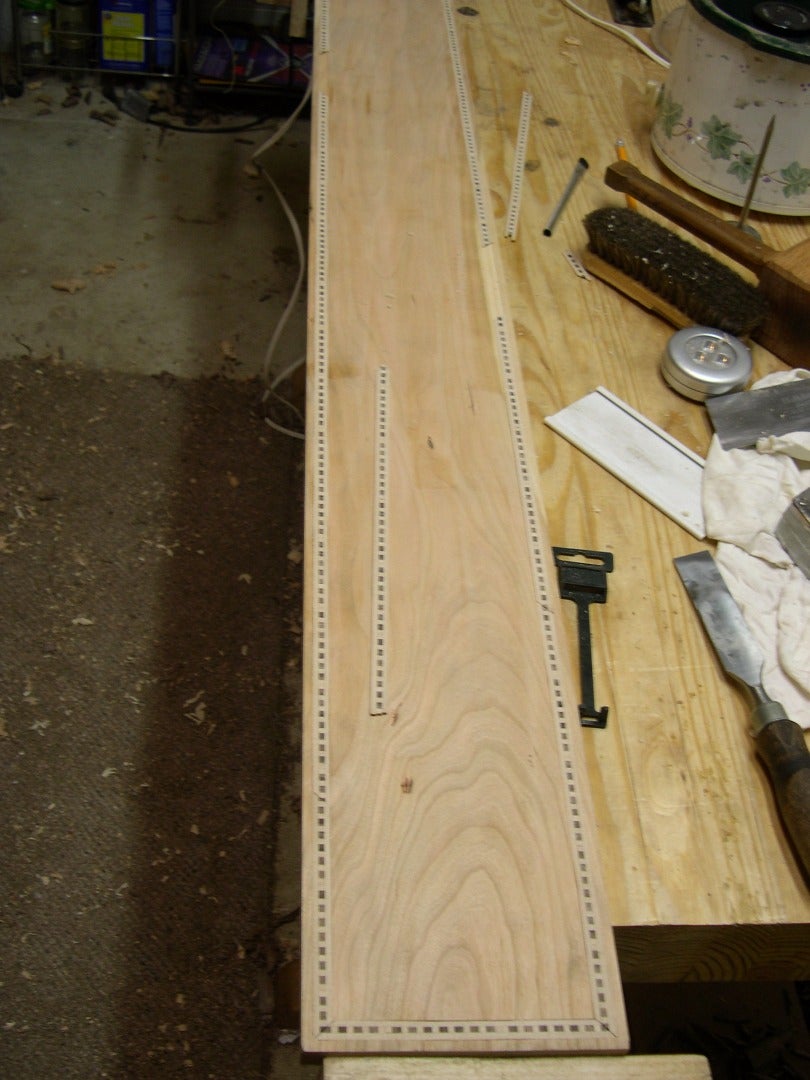

I installed the banding at one edge of the board and worked my way all around the border using miters to join the pieces together. To find out where I should cut the miters on the board ends, I laid a strip of banding in the groove and marked with a fine, sharp pencil where it butted up against the inside groove of the adjacent edge. Using my chisel, I then placed its corner (with the bevel towards the waste) on the pencil mark, and slowly rotated the chisel out until I saw a sharp 90 degree turn in the chisel's back. I then cut the miter using a rocking motion, taking my time to slice through it completely.

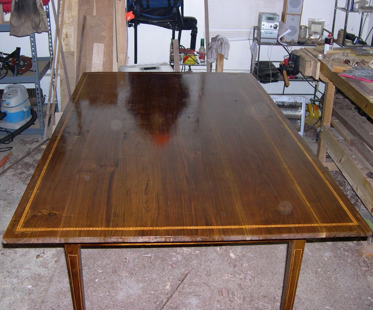

The banding I used was leftover from my Federal dining room table project. This banding is pretty simple to make and consists of alternating strips of black walnut and sycamore that I sawed off and glued between two narrow pieces of sycamore. If you want to save time on the project, or are unsure of how to make banding, you can easily purchase some from either Woodcraft (http://www.woodcraft.com/) or Lee Valley (http://www.leevalley.com/).

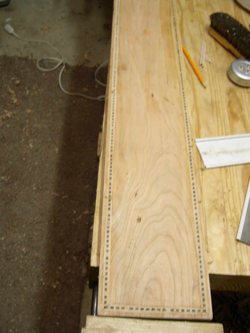

After all pieces of banding were mitered and fitted, I used hot hide glue in the grooves to glue the banding down. I prefer hot hide glue for inlay work like this because it sets quickly, it's reversible, and you can apply most finishes over hide glue without any problems. If you don't have hot hide glue, you can easily use white PVA glue instead. Just make sure to press the banding firmly down into the groove with the glue and clean up any squeeze out that occurs.
Once the glue had set and fully cured overnight, I used a smoothing plane to take the banding inlay down flush with the board, and followed up with a card scraper.

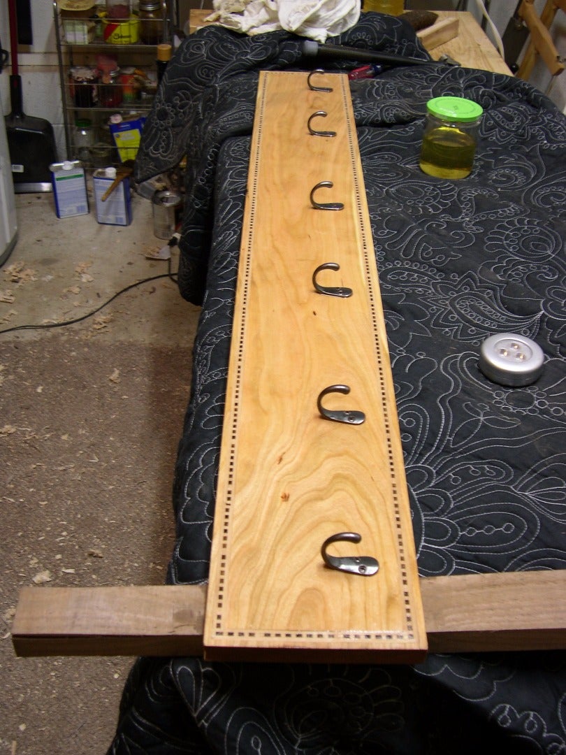

To install the hardware, I marked down an inch and a half from the bottom edge of the banding and transcribed my measurements for the pots so that I knew exactly where the hooks would go. I should point out that the spacing for the hooks is different because I have different sized pots.
With the markings made, I then placed the hardware on the center and marked the center for the screws. I drilled pilot holes for all the screws, and made sure to wax the threads with paraffin.
