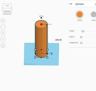

  • Measure your bottle's diameter and length.
  • Open TinkerCad at https://www.tinkercad.com/.

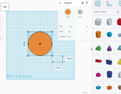

  • Create a bottle shape similar to yours, but 5mm wider in diameter. Drag a cylinder onto the canvas.
  • Switch to "Top" view and adjust the diameter using the small white squares. Mine was 70mm.
  • Rotate the view as needed. Increase the height to match your printer's capability or the bottle's maximum height. Mine was 220mm.

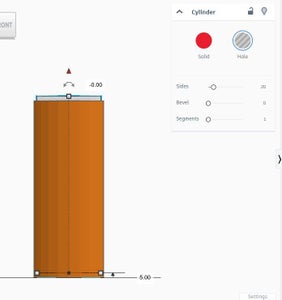

Step 2: Modelling the Pot

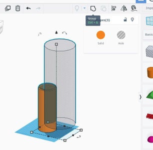

  • Copy the bottle using Ctrl+C, Ctrl+V.
  • Increase the diameter of the copied cylinder by 6mm.
  • Position the cylinders concentrically (red and yellow).
  • Select the red cylinder, click the "hole" tab in the property menu to turn it grey.
  • Move the grey cylinder 5mm upwards.
  • Copy the grey cylinder, place it to the side to make a cut, and resize it accordingly.
  • Select all and group them using the group button in the upper right corner.

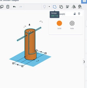

Step 3: Thread Holes
  • Now that the bottle part is ready, add the threaded hole for the bottle. Include a cylinder hole as shown and group them together.

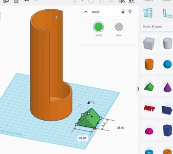

Step 4: Add a Slope Holder
  • To prevent water from flowing out when the pot is placed on the ground, add a prism-shaped part from the Tinkercad menu.
  • Scale it up by dragging any corner while holding shift.
  • Position the prism near the top as shown in the next steps.

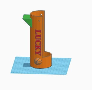

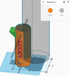

Step 5: Final Touches
  • To remove the small visible part of the prism, we have to delete it.
  • Before that, add designs as you like from the Tinkercad directory, including your dog's initials if you like.
  • To clear the inside of the pot, ungroup all parts to reveal the inner cylinder hole. Then, regroup all parts. The inner hole will clear the excess extrusions.
  • Voila! Your companion's pot is now ready!
