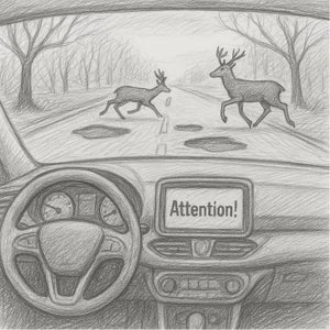

This project describes the development of a real-time road pothole and animal detection and classification system, designed as a comprehensive solution for improving road safety. The system leverages modern computer vision techniques to automatically detect and classify different types of road potholes (dangerous and safe) as well as animals, providing timely alerts to the driver.
The primary motivation for this project is the increasing need to ensure driver and passenger safety, reduce vehicle damage, and minimize accidents caused by undetected road hazards. The solution is intended for integration into vehicles, city transportation, or for use by road maintenance organizations.

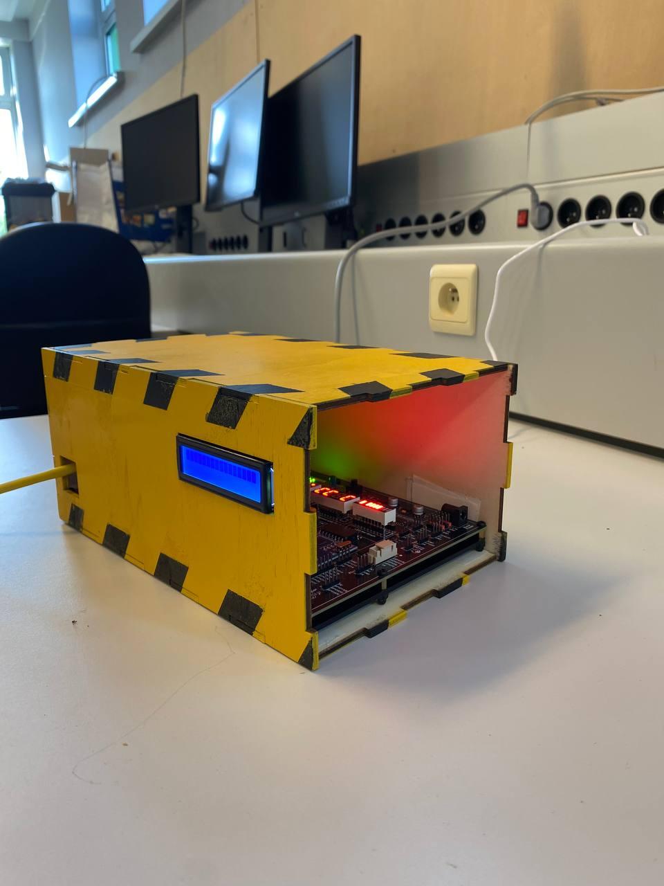

Raspberry Pi 5: Acts as a remote notification unit, processes commands, and drives display/alerts.
Ethernet Cable: For direct and stable connection between the laptop and the Raspberry Pi.
16x2 I2C LCD Display: Used to show driver alerts (all clear, warning, safe pothole, etc.).
Buzzer (Passive Audio Output): Provides audible alerts in case of detected danger (dangerous pothole or animal).
Basic electronic components and wiring: For connecting the LCD and buzzer to the Raspberry Pi.

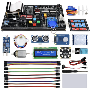

Additional: You can use Freenova Projects Kit for Raspberry Pi (different versions).

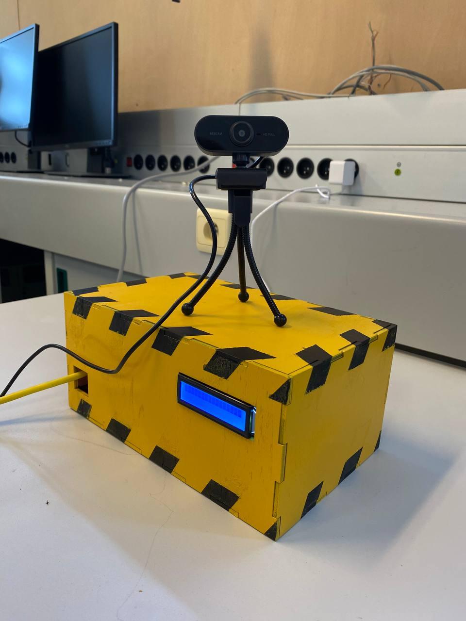

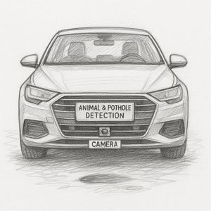

  1. Webcam Placement:
  2. For this project, a standard USB webcam is used. Ideally, it should be mounted in the location where a real-world automotive radar/camera would be installed — for example, on the vehicle's front bumper, aimed at the road ahead.
  3. In the prototype, the webcam is simply connected to the laptop via USB.
  4. Laptop:
  5. Used for real-time video capture and running the YOLOv8 detection model.
  6. Handles all frame processing and detection, then sends results to the Raspberry Pi via Ethernet.

  1. I2C LCD Display:
  2. Connect the 16x2 LCD display via I2C to the Pi.
  3. Buzzer:
  4. Connect the passive buzzer to a GPIO pin (e.g., BCM 4), for audible alerts.

Once the model is trained, the inference pipeline is deployed on the laptop, which is connected to a standard webcam. The webcam captures real-time road video. Each frame is processed by the trained YOLOv8 model, which detects and classifies objects of interest (potholes and animals) in real-time. The results—including object type and bounding box—are displayed directly on the screen with colored overlays. The software also forms a status message based on the detected classes.
Step 6: Communication With Raspberry Pi and Output Notification

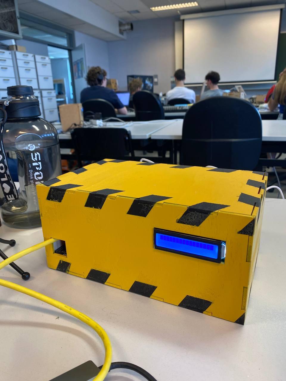

The processed detection results are transmitted from the laptop to the Raspberry Pi 5 using an Ethernet cable for fast and reliable data transfer. The Raspberry Pi receives information about detected potholes and animals via HTTP requests. Based on the received data, the Pi displays relevant messages on the LCD screen. If a dangerous pothole or animal is detected, an audible warning is triggered using a buzzer to immediately alert the driver. Safe potholes or clear road status are also communicated through the LCD.
Step 7: Real-Time Operation and User Interface
The entire system operates in real time: the webcam constantly streams video, the laptop performs object detection and classification, and the Raspberry Pi provides timely notifications to the user. All alerts are displayed on the LCD, and critical events (such as dangerous potholes or animals) are accompanied by a buzzer signal. The terminal on the laptop also provides textual information about detections for operator reference. The system is designed for ease of use and rapid response, ensuring that drivers receive immediate feedback on hazardous road conditions.
