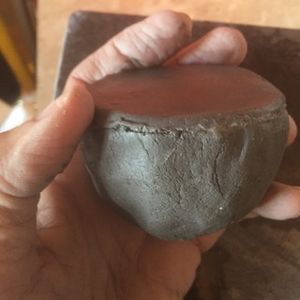

Step 3: Join the Pieces
Trim the bowl edge to ensure a smooth connection.
Score the edges of the bowl and the perimeter of the base. Brush both edges with water.
Carefully press the bowl firmly to the base. Smooth the seam.

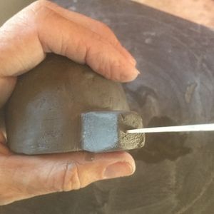

Step 4: Add the Mouthpiece
Form a rectangle that's an inch long and about half an inch on each side. This must be attached flush with the bottom of the bird.
Score both the end of the mouthpiece and the spot where it will be attached.
Brush both scored surfaces with water and attach, pressing firmly.
Slide the coffee stirrer into the mouthpiece, and push through into the open section of the body.

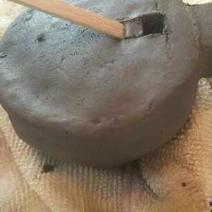

Step 5: Cut the Air Hole
Lay a stirrer along the base and score a line. (It needs to fall inside the wall--you need a clear hole into the cavity.)
Then lay the stirrer perpendicular to that line and score on each side of the stirrer. Slide the stirrer into the air hole in the mouthpiece, all the way to the front wall. Hold it flat. Using the Xacto knife, cut the scored square of clay completely out and remove it.
