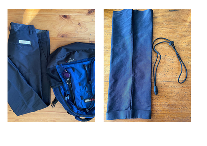

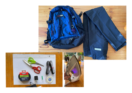

- A pair of thrifted pants (or fabric)
- Used 93 cm of webbing
- 6cm of Velcro (can also use snap buttons)
- 40cm of elastic (I used some from an old backpack)
- Lighter or candle/matches
- 25mm Webbing ( I reused some webbing from backpacks/bags and also bought some black webbing from Bunnings https://www.bunnings.com.au/grunt-25mm-x-10m-black-poly-webbing_p4310851
Tools
- Pins
- Ruler
- Pens/Pencils
- Fabric and Paper Scissors
- Iron
- Needle and Thread
Step 1: Cutting Material
- I removed the elastic from the backpack to use later
- I cut the pants 30cm long ways and the pants were 18-20cm wide (I used the lager width at the top)

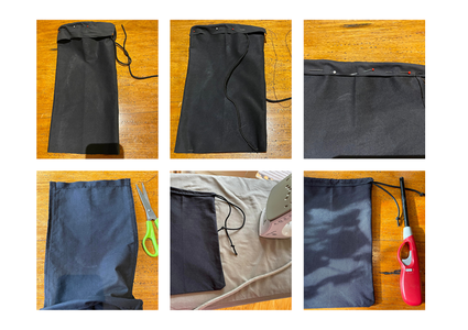

Step 2: Sewing the Sack
- I folded over the top seam twice
- Put elastic in between the fabric
- Pinned and sewed down the seam
- Turned inside out and sewed the bottom seams together
- Burnt the ends of the elastic

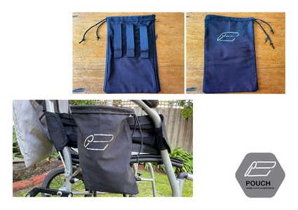

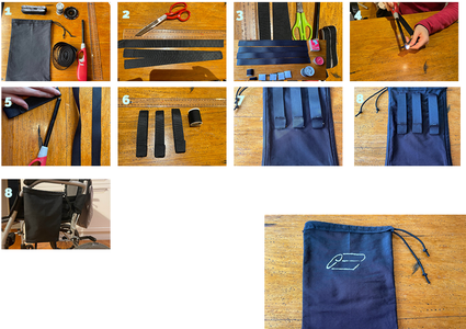

Using the sack bag connect three straps to the back, follow the images and instructions
- Collect materials: Webbing, needle and thread, velcro or snap buttons and lighter
- Cut 31cm pieces of webbing for the amount of straps you want (I used three straps, the straps are place 2.5cm apart)
- Add a 2x2 cm square of velcro or a snap buttons to opposites sides of the webbing
- Got lighter ready to burn the edges of the webbing
- Burn both of the edges of the webbing
- Connect the Velcro and flatten the webbing to make sure it stays flat, burn the edges, sew on the velcro
- Pin the straps 2.5cm apart and sew the back rectangle to the bag
- Sewn straps
- (Optional)Connect straps to the Pouch Molle system sides
