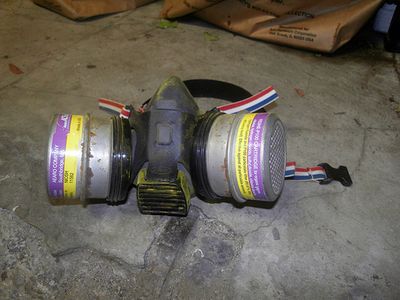

Finally, remember that the powder pigment is a very fine dust and will easily coat your lungs and get in your eyes, so get a NIOSH-approved respirator and wear goggles while working. You'll need a workspace you can sweep or hose down after the dust settles. I made the mistake of leaving the door open between my workshop and a room where I keep some computer servers. Afterward, I noticed the server filters had turned red and yellow from all the powder they sucked in. But it all vacuums up or blows off easily.
